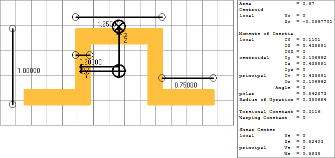

Shell Sections

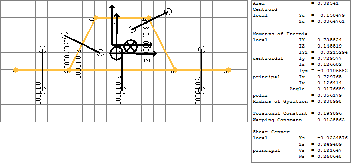

Solid Sections

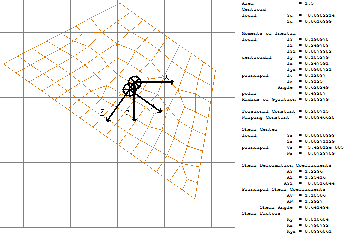

Standard Sections
Figure 3.
