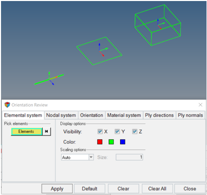

Elemental System
Plot the default element coordinate system for 1D, 2D, or 3D elements.
| Option | Action |
| Pick Elements | Select elements on which to plot x, y, and/or z element system directions. |

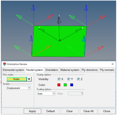

Nodal System
Plot systems associated with nodes.
Typically used to review displacement and reference systems in the OptiStruct and Nastran user profiles.
| Option | Action |
| Pick Nodes | Select nodes on which to display system information. |
| System | Determines system type to plot. Specific to OptiStruct and Nastran displacement and reference
systems on GRID card. Choose from:

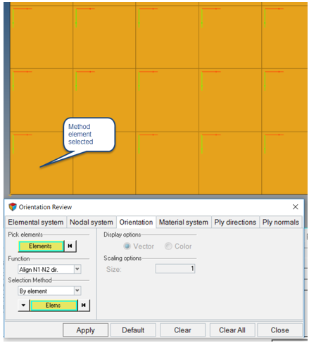

Element Orientation
Plot and manipulate the order of nodes that sets default element coordinate systems.
Element orientations for most solvers are determined by the sequence of nodes on the element card. This tab provides several methods of node renumbering to change element coordinate system x or z axis.
| Option | Action |
| Pick Elements | Select the elements on which to manipulate node numbering. |
| Function | This provides several methods of reviewing elemental system
directions and changing node ordering. Choose from:
| Align N1-N2 dir. Methods | Set the N1-N2 direction of selected elements as close as
possible to the input method, without remeshing. The tool will
not change the element normal. Intended for legacy OptiStruct and Nastran use cases. In typical cases, use
material orientation methods to set material directions. The
following methods are available:

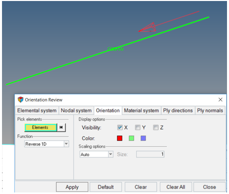

Orientation Usage – Reverse 1D
How to use the Orientation tab.
Orientation Usage - Align N1-N2 Direction

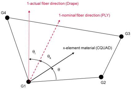

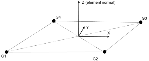

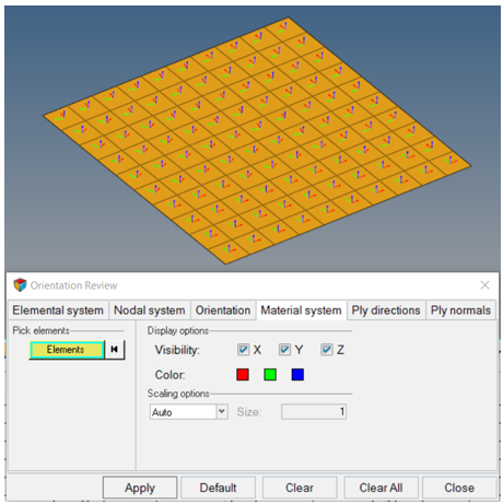

Material System
Plot the material coordinate system on elements.
Figure 6.
| Option | Action |
| Pick Elements | Select elements on which to plot x, y and/or z material system directions. |
Material System Usage
How to use the Material System tab.

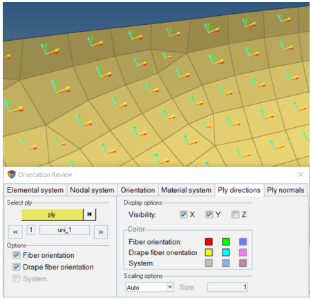

Ply Directions
Plot the 1, 2 and/or 3 directions of plies.
Figure 8.
| Option | Action |
| Select ply | Select a ply to plot orientation by clicking the yellow ply collector. Alternatively, use the arrows to move through the list of plies in the model. |
| Options | Choose which ply directions to plot:

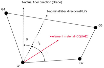

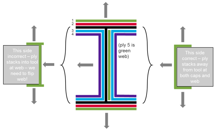

The discontinuity in stacking direction on the left side of the I-beam model will be corrected using ply normals. Ply normals manipulate the direction an individual ply stacks. When the ply normal tool is used to reverse a ply normal, a drape table is created for the ply. It subtracts 2*θ from the ply orientation which is mathematically equivalent to flipping the direction the ply is stacked.

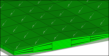

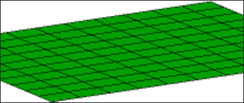

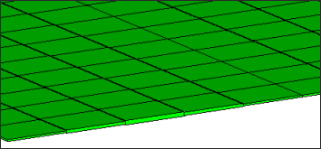

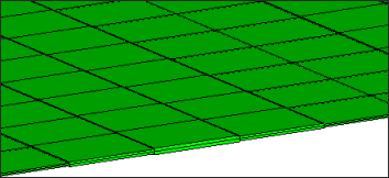

- 2D Traditional Element Representation (
) - HyperMesh represents composite layers, when visible,
as 2D shells:
Figure 11. Layers Off
Figure 12. Composite Layers

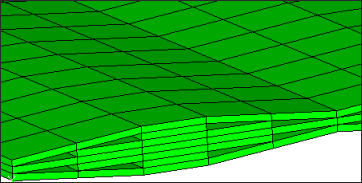

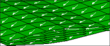

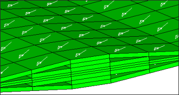

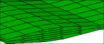

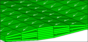

Figure 13. Layers with Fiber Direction - 2D Detailed Element Representation (
Figure 14. Layers Off
Figure 15. Composite Layers
Figure 16. Layers with Fiber Direction - 2D Traditional and Detailed Element
Representation (
Figure 17. Layers Off
Figure 18. Composite Layers
Figure 19. Layers with Fiber Direction
