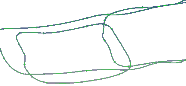

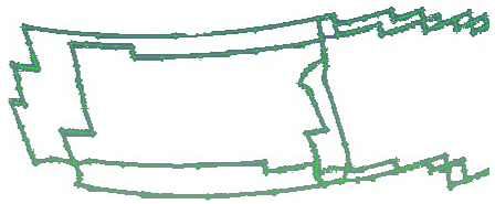

Ply Geometry Smoothing
Ply Geometry Smoothing provides functionality to smooth finite element ply shapes, usually generated from concept level composite freesize optimization, and to generate geometry from finite element ply shapes.

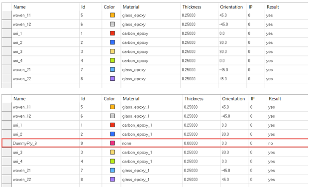

Ply Auto Rename
Ply Auto Rename changes ply names so that the assigned material, thickness and angle are appended.
From the menu bar, click .
Figure 3. Ply Names as Defined in the CAD System
Figure 4. Updated Ply Names

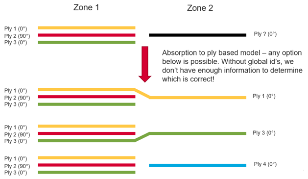

FE Absorb Plies
FE Absorb Plies generates a ply-based model from zone-based properties.
Entities that are created are laminates, plies, and template properties.
Figure 5.

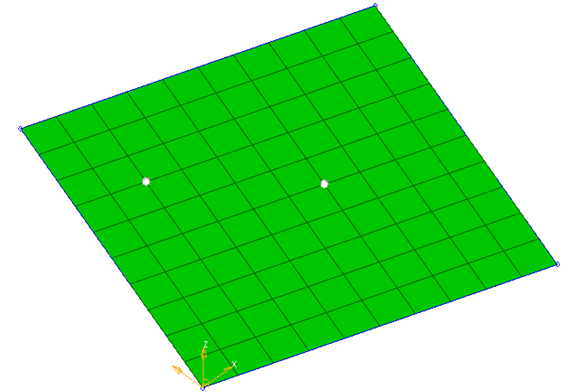

- Select the elements for which a new material angle will be assigned.
- Select the lines or list of nodes to define the material direction. The
element centroid will be taken and projected to the closest line/node
segments and the line tangent direction will be found to assign the material
angle.

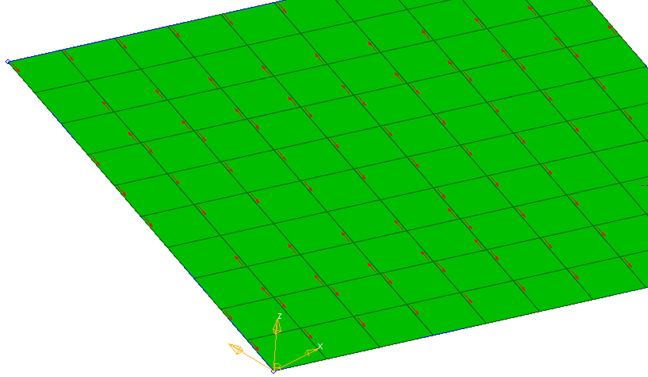

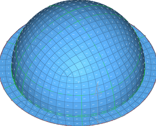

Figure 8. A Circular Pattern of the Material Orientation is Assigned Based on the Outer Circular Line Direction

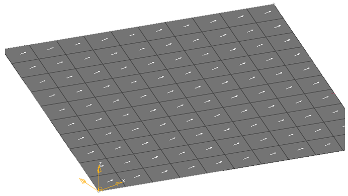

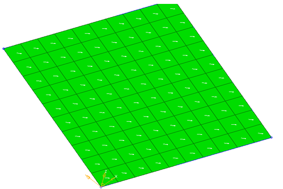

Figure 9. Two Nodes are Selected for Material Direction
Figure 10. Material Direction in the Same Direction as two Nodes

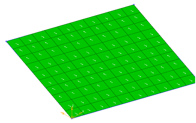

By System Axis
Figure 12. System Local Axis 2 is Projected to Create Material System

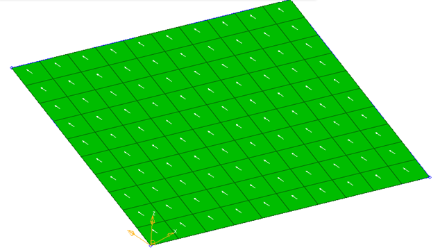

By Angle
Figure 13. Element N1-N2 Direction
Figure 14. Material System is Created at an Angle to N1/N2 Direction

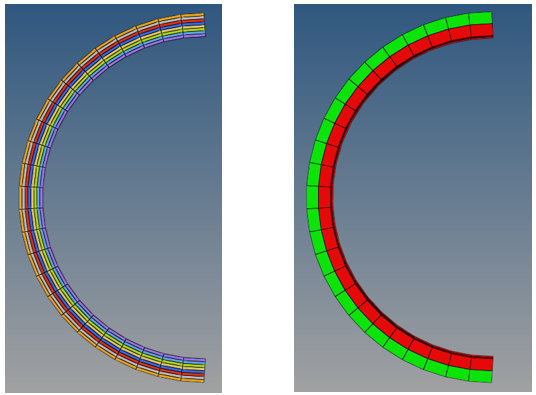

Shell To Solid Conversion
The Shell To Solid Conversion tool provides functionality to generate solid elements and material orientations from a ply based shell model.
