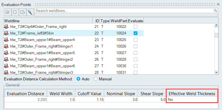

- Effective Weld Thickness (Ar)
- Ar (resulting weld thickness) is user-defined input. Based on this
parameter, there is a provision to reduce the stress values that are
captured from FE in specific sheets of the connection according to the
formula:

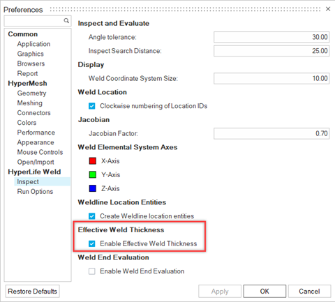

Stress (corrected) = Stress (current) * Ar / shell thickness. This applies only to the stress normal to the weld and the shear stress. By default the value of Ar is set for the minimum shell thickness and then you can modify the value accordingly.Tip: Turn on the Enable Effective Weld Thickness option in Preferences to automatically set all weld lines to Yes in the Points Context. The option is disabled by default.

Figure 3. - The default effective thickness calculated in the weld line browser under location details is based on the
following tables.
Table 1. Weld Locations Effective Thickness T-Weld 3, 4 0.7 0.7 * L-Weld 1, 2, 3, 4 0.7 0.7 * Butt-Weld 1, 2, 3, 4 1.0 1.0 * Overlap 3, 4 0.7 0.7 * M-Weld 3, 4, 7, 8 0.7 0.7 * X-Weld 3, 4, 5, 6, 9, 10 0.7 0.7 * Table 2. Weld Locations Effective Thickness T-Weld 1, 2, 5, 6 1.0 1.0 * Overlap 1, 2, 5, 6 1.0 1.0 * X-Weld 1, 2, 5, 6 1.0 1.0 * M-Weld 1, 2, 5, 6 1.0 1.0 * - The default calculated effective thickness can also be manually edited.
