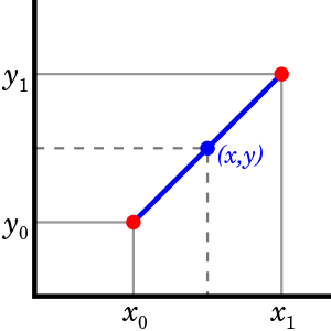

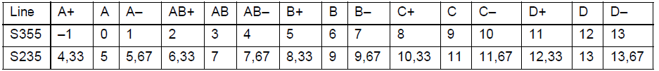

- How does the exponent x interpolation work?
In case of DVS 1612, the value of exponent ‘x’ depends on the material grade and has different values based on the grades of S235 and S355. But, whenever the base/web material does not fall into either of these grades, then the tool uses an interpolation technique to find the intermediate ‘x’ exponent value.
Figure 2.- The tool retrieves the material grade/yield assigned for the particular location from the classification area.
- The tool also identifies the fatigue class/notch case for the particular location from the classification area.
- Based on this fatigue class, the tool retrieves both the values of exponent 'x' from the “regulation_ data” folder belonging to the grades S235 and S355.
- An initial check is carried out to determine if the material yield is higher than the highest grade (S355) or if it is lower than the lowest grade. If so, then the tool considers the exponent 'x' to belong to the highest/lowest grade respectively for calculation.
- If the material yield value is in between the two grades, then the tool calculates the intermediate value of exponent ‘x’ using a linear interpolation technique. The calculated value of exponent ‘x’ is then used for utilization calculation.
