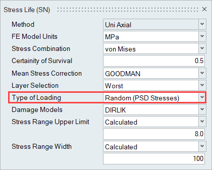

Setup
Figure 3.

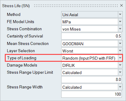

Setup
After loading an FE result file that contains a Frequency Response Analysis subcase, Random Response Fatigue is activated by setting the Type of Loading field to Random (Input PSD with FRF).
Figure 4.

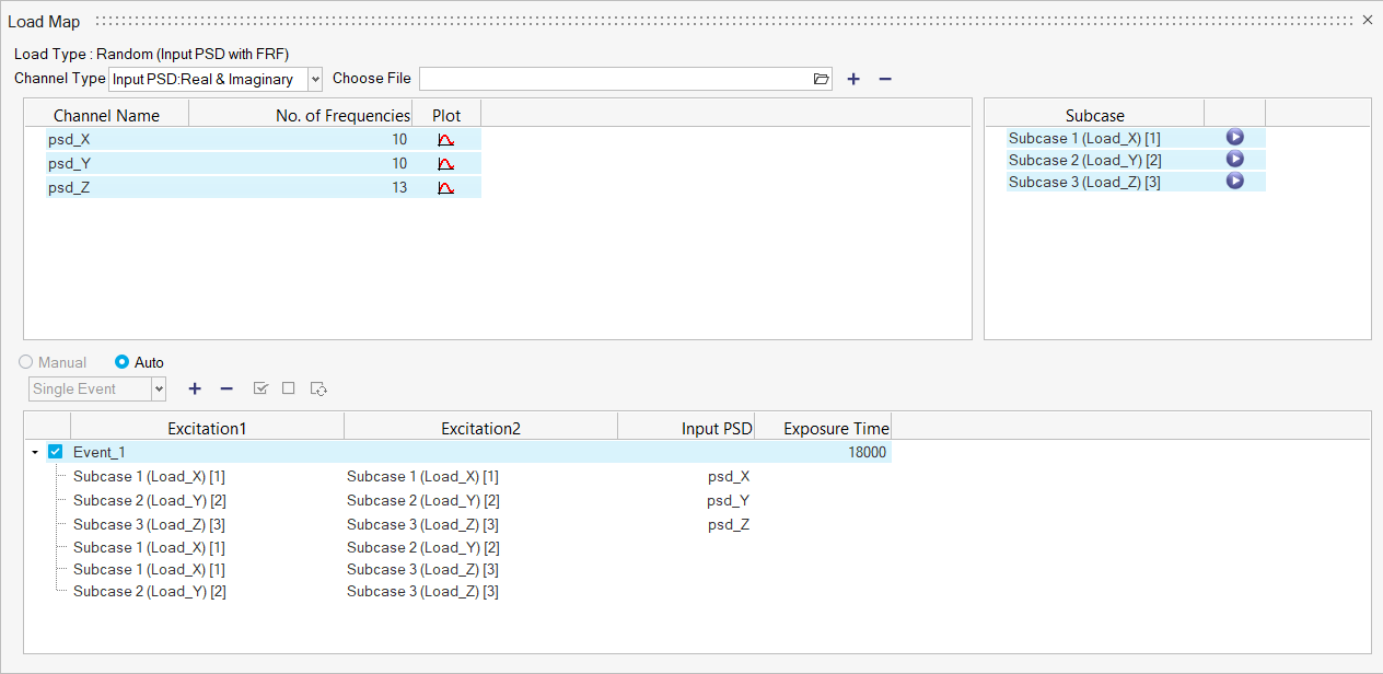

Loadmap:
- Input PSD: Real and Imaginary
- Input PSD: Magnitude and Phase
Figure 5. Event Creation in the Load Map Dialog for Random Fatigue with FRF Stresses and Input PSD
Excitation1 and Excitation2 refer to the correlations of the FRF subcases. The Input PSDs are used to scale the complex stresses. If the Input PSDs are of the Phase and Magnitude form, they are internally converted to Real and Imaginary.
