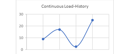

Figure 3. Continuous Load HistorySince this load history is continuous, it is converted into a load history consisting of peaks and valleys only.

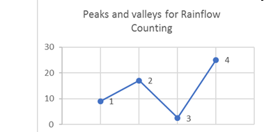

Figure 4. Peaks and Valleys for Rainflow Counting. 1, 2, 3, and 4 are the four peaks and valleysIt is clear that point 4 is the peak stress in the load history, and it will be moved to the front during rearrangement (Figure 5). After rearrangement, the peaks and valleys are renumbered for convenience.

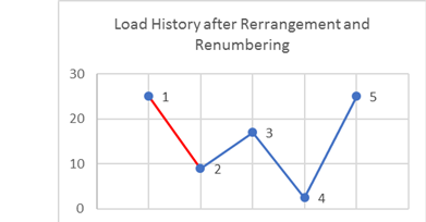

Figure 5. Load History after Rearrangement and RenumberingNext, pick the first three stress values (1, 2, and 3) and determine if a cycle is present.
If represents the stress value, point then:(2) (3) As you can see from Figure 5 , ; therefore, no cycle is extracted from point 1 to 2. Now consider the next three points (2, 3, and 4).(4) (5) , hence a cycle is extracted from point 2 to 3. Now that a cycle has been extracted, the two points are deleted from the graph.

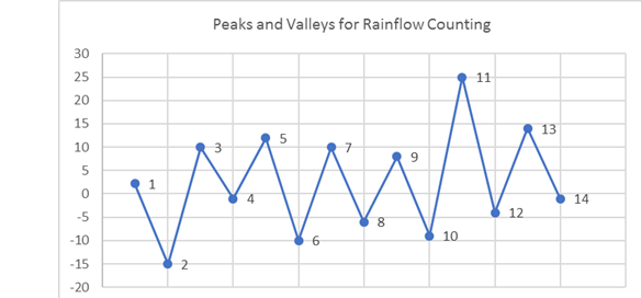

Figure 7. Continuous Load HistorySince this load history is continuous, it is converted into a load history consisting of peaks and valleys only:
Figure 8. Peaks and Valleys for Rainflow CountingClearly, load point 11 is the highest valued load and therefore, the load history is now rearranged and renumbered.

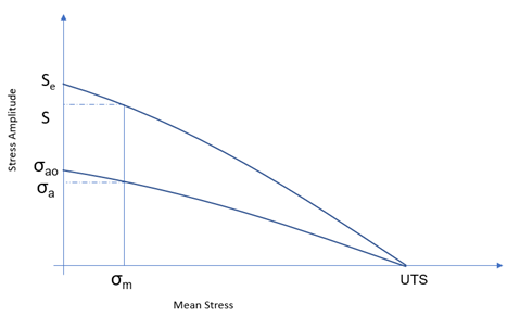

The Gerber method treats positive and negative mean stress correction in the same way that mean stress always accelerates fatigue failure, while the Goodman method ignores the negative means stress. Both methods give conservative result for compressive means stress. The Goodman method is recommended for brittle material while the Gerber method is recommended for ductile material. For the Goodman method, if the tensile means stress is greater than UTS, the damage will be greater than 1.0. For the Gerber method, if the mean stress is greater than UTS, the damage will be greater than 1.0, with either tensile or compressive.
Figure 10. Haigh Diagram and Mean Stress Correction Methods

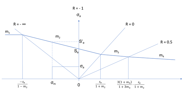

Figure 11.
There are 2 available options for FKM correction in HyperLife. They are activated by setting FKM MSS to 1 slope/4 slopes in the Assign Material dialog.
- Regime 1 (R > 1.0)
- Regime 2 (-∞ ≤ R ≤ 0.0)
- Regime 3 (0.0 < R < 0.5)
- Regime 4 (R ≥ 0.5)
- Stress amplitude after mean stress correction (Endurance stress)
- Mean stress
- Stress amplitude
- Slope entered for region 2
If all four slopes are specified for mean stress correction, the corresponding Mean Stress Sensitivity values are slopes for controlling all four regimes. Based on FKM-Guidelines, the Haigh diagram is divided into four regimes based on the Stress ratio () values. The Corrected value is then used to choose the S-N curve for the damage and life calculation stage.
