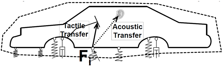

Traditional TPA Process (two-step TPA)
Step 1: Calculate attachment Forces of the system in an assembled state:
Step 2: Calculate Transfer Functions (TF) of the responding structure in an isolated state:
