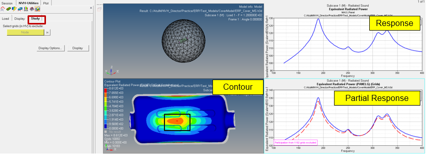

The Equivalent Radiated Sound utility post-processes the results of exterior structure-borne radiated sound.
Load an H3D or PCH results file and plot a response for the Equivalent Radiated Power, Sound Power, or Sound Pressure result types.
After loading a file, use the Display tab to select a contour type and a concerned frequency.
After plotting curves, perform a response study for Equivalent Radiated Power.
