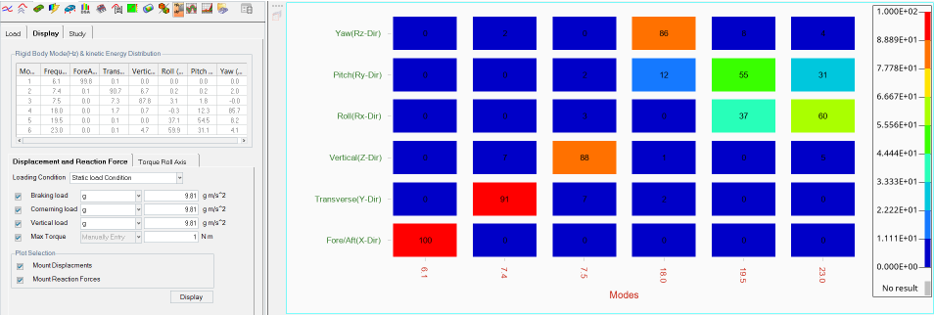

Mount Optimization - Display Tab
Review rigid body mode frequencies and corresponding kinetic energy distribution.
Figure 1. Mount Optimization Utility - Display Tab
