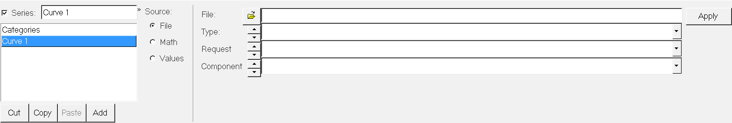

File as a Data Source
Figure 2. Source = File

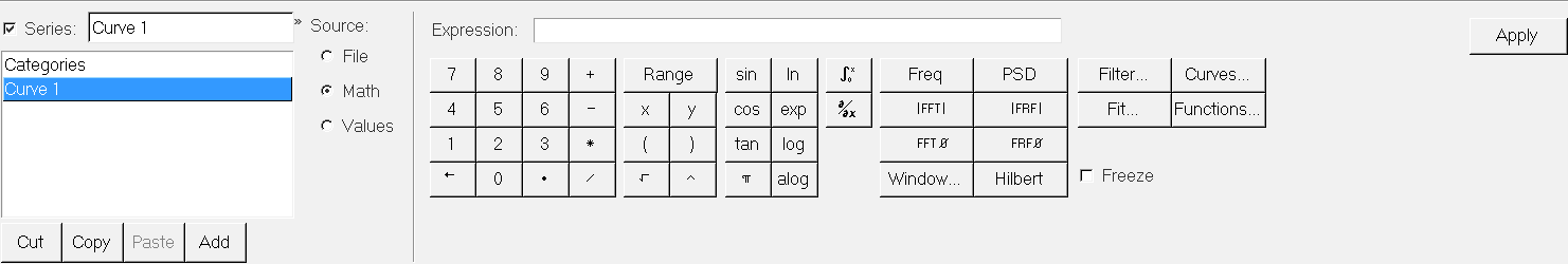

Math as a Data Source
Figure 3. Source = Math

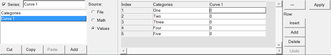

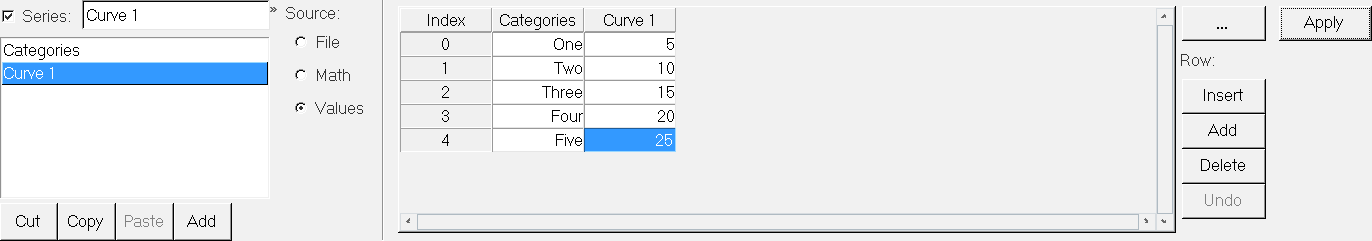

Values as a Data Source
Figure 4. Source = Values

- Curve
- Data point values can be entered directly into the Curve column in the Values table. Enter numbers in the Curve columns and click Apply. After adding a curve to the Curve list, a Curve column is displayed next to the Categories column. By default, a new curve is named Curve 1, Curve 2, and so on. If you change the name of the bar chart curve in the Curve list, the heading for the Curve column in the Values table also changes.
From the Row group box, you can insert, add, and delete rows in the Values table.
