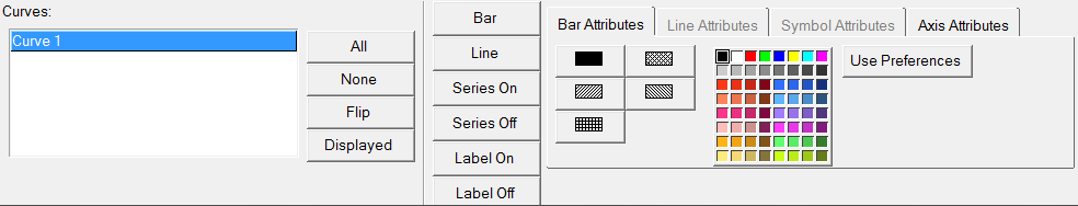

Figure 1. Curve Attributes panel - Bar Attributes tab

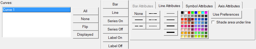

Figure 2. Curve Attributes panel - Line Attributes tab

Select Bar to display the y-data value as a bar chart. If you select Bar, only the Bar Attributes and Axis Attributes tabs are displayed.
Select Line to display the y-data value as a line curve. If you select Line, only the Line, Symbol, and Axis Attributes tabs are displayed. When a curve is turned off, the lines and symbols are no longer displayed and the legend does not include curve information.

Line Attributes
Line styles can be assigned to curves to help differentiate different curves on a plot.
Figure 3.
Click on a line style to apply the style to the currently selected curves.
When None is assigned as a line style, the line is no longer displayed but the symbols assigned to the curve remain visible, creating a scatter plot of the curve. The curve is still displayed in the legend.
In addition to different line styles, line thickness can also be assigned to a curve. The line weight for each curve is displayed in the legend. Click on a line weight to change the thickness of the currently selected curves.
Any of the 64 colors can be assigned to a curve. Select a color from the color palette to change the color of the selected curves.

Bar Chart Styles
Styles can be assigned to bar charts to help distinguish them in an HyperGraph 2D window.
From the , click a bar chart style to apply it to the currently selected bar chart curve. You can apply a solid color to a bar or you can apply 1 of 4 line patterns to a bar. To change either the solid color or the line pattern color, select any of the 64 colors from the color palette. The style selected for each bar chart is displayed in the legend.
