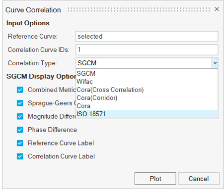

- From the Plot Browser, select a reference curve, right-mouse click, and select Curve Correlation.

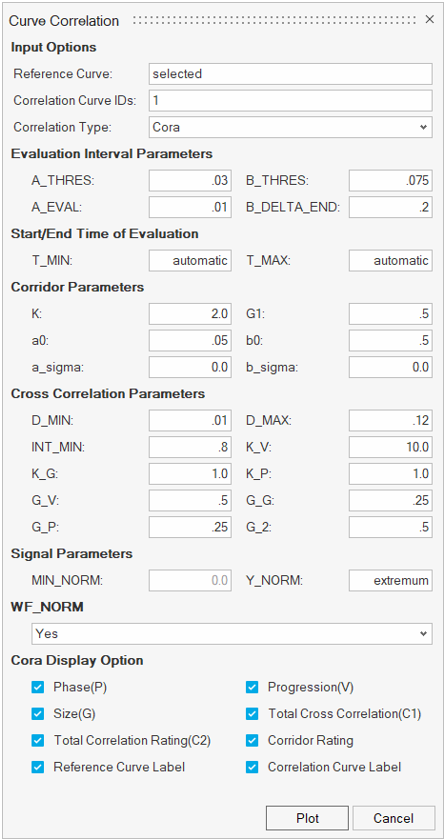

- From the Correlation Type drop-down menu, select a correlation method.
Figure 1. - Select Cora to display the following options.
Figure 2. - Retain the default settings or change the defaults per your requirements and
click Plot.
Notes are displayed with the correlation metrics in the plot window.

- Correlation Type
- Supported methods include:
- SGCM
- Wifac
- Cora(cross correlation)
- Cora(Corridor)
- Cora
- ISO-18571
Cora Parameters
- Evaluation Interval Parameters
- Description
- A_THRES
- Threshold to set the start of the interval of evaluation. Varies between 0 and 1.
- B_THRES
- Threshold to set the end of the interval of evaluation. Varies between 0 and 1.
- A_EVAL
- Automatically calculated interval of evaluation. Varies between 0 and 1.
- B_DELTA_ENDis
- Shortens the end of the interval of evaluation if it is calculated automatically. Varies between 0 and 1.
- Tmin/ Tmax
- Defines the starting and the ending time of the evaluation interval.
- Corridor Parameters
- Description
- K
- Exponent factor (progression) for the calculation of the corridor rating.
- G-1
- Weighting factor of the corridor rating.
- a0
- Width of the inner and outer corridor.
- b0
- Width of the outer and outer corridor.
- a_sigma
- Factors of the standard deviation to widen the inner corridor.
- b_sigma
- Factors of the standard deviation to widen the outer corridor.
- Cross Correlation Parameters
- Description
- D_MIN
- Calculates the interval of evaluation. Varies between 0 and 1.
- D_MAX
- INT_MIN
- Minimum overlap of the interval. Varies between 0 and 1.
- K_V
- Exponent factor (progression) of the calculation of the progression rating, V.
- K_G
- Exponent factor (progression) of the calculation of the size rating, G.
- K_P
- Exponent factor (progression) of the calculation of the phase shift rating, P.
- G_V
- Weighting factors of the progression rating.
- G_G
- Weighting factors of the size rating.
- G_P
- Weighting factors of the phase shift rating.
- G_2
- Weighting factors of the cross-correlation method.
- Signal Parameters
- Description
- MIN_NORM
- The limit to start special treatment of secondary axis. Varies between 0 and 1.
- Y_NORM
- Type of calculation of Y_NORM; options include extremum or value.
- WF_NORM
- Normalization of the weighting factors; options include YES or NO.

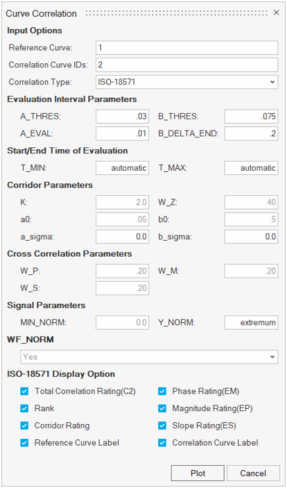

Select ISO-18571 to display the following options:
Figure 3.
ISO-18571 Parameters
- A_THRES
- B_THRES
- A_EVAL
- B_DELTA_END
- Tmin/ Tmax
- This keyword defines the starting and the ending time of the interval of evaluation.
- K
- W_Z
- a0
- b0
- a_sigma
- b_sigma
- Cross correlation Parameters
- W_P
- Weighting factor of the phase score.
- W_M
- Weighting factor of the magnitude score.
- W_S
- Weighting factor of the slope curve.
- Signal Parameters
- MIN_NORM
- The limit to start special treatment of a secondary axis. Varies between 0 and 1.
- Y_NORM
- WF_NORM
Cora Display Options
- Phase(P)
- Display the phase value.
- Progression(V)
- Display the Progression value.
- Size(G)
- Display the Size value.
- Total Correlation Rating(C2)
- Display the Total Correlation Rating value.
- Total Cross Correlation Rating(C1)
- Display the Total Cross Correlation Rating value.
- Corridor Rating
- Display the Corridor Rating value.
- Reference Curve Label
- Display the Reference Curve label.
- Correlation Curve Label
- Display the Correlation Curve label.
ISO-18571 Display Options
- Phase Rating(EM)
- Display the Phase Rating value.
- Rank
- Display the rank value.
- Magnitude Rating(EP)
- Display the Magnitude Rating value.
- Corridor Rating
- Slope Rating(ES)
- Display the Slope rating value.
