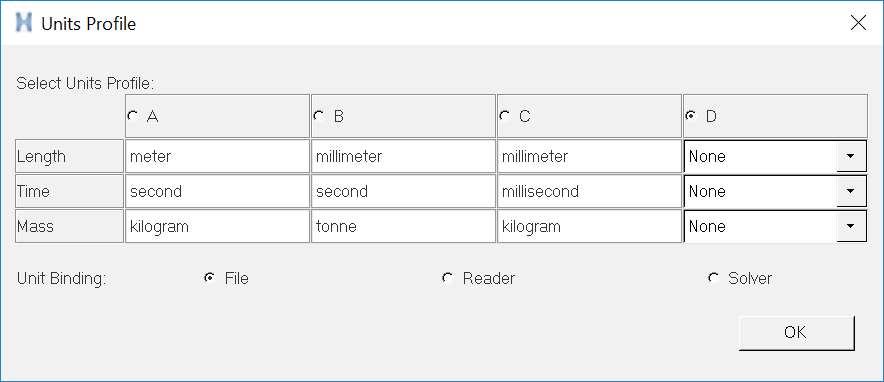

Units Profile Dialog
When a file does not contain unit metadata, use the Units Profile dialog to select and enable a pre-defined unit system for the file so that the units do not have to be defined every time more data is plotted.
- LS-DYNA
- Radioss T01
Figure 1. Units Profile dialog
- Select Units Profile
- Dyna uses three common profiles of consistent units A, B, and
C.
- A
- Uses meter, second, and kilogram.
- B
- Uses millimeter, second, and tonne.
- C
- Uses millimeter, millisecond, and kilogram.
- D
- Includes the remaining unit systems.
- Unit Binding
- Sets different levels of the unit binding.
- File
- Enables units to the loaded file only.
- Reader
- Enables units to any file that uses this particular file reader.
- Solver
- Enables units to any file from a particular solver.

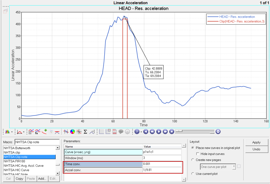

In the image below, units are not enabled for the selected curve. After loading the curve, select a vehicle safety tool (VST) function such as clip from the Injury menu. Without units enabled, you must manually enter the scaling factors in the Timv conv. and Accel conv. fields so that the curve fits properly.

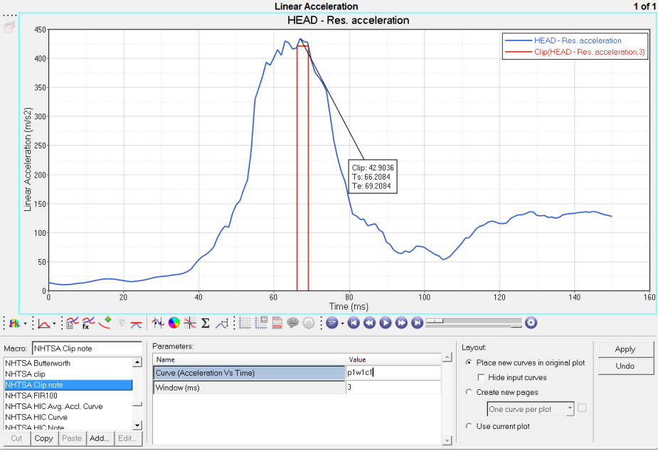

However, with units enabled, and with the same curve and VST function selected, there is no need to manually adjust the scaling factors; the scaling is applied automatically. Notice in the image below, the Time conv. and Accel conv. fields are no longer there.
With units enabled, you can also use the Convert Units context-sensitive menu to change the axes values from ms to s for the Time axes in the image below, or from m/s2 to gravities for the Linear Acceleration axis below. Doing this does not affect the values as shown in the curve note shown in this image; they will remain the same.

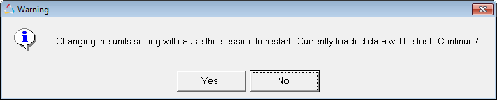

If units are not enabled and you return to the Options panel to enable them, the HyperGraph session will restart. The message shown below is displayed. Click Yes to restart the session with units enabled.

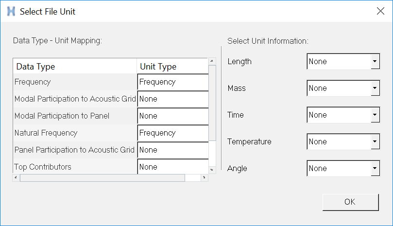

Select File Unit Dialog
For a file with a recognized unit system, use the Select File Unit dialog to set the data types to a known unit type.
Set the atomic units (length, mass, time, temperature, and angle) to a unit system.
- Abaqus
- OptiStruct PCH and OP2
- Nastran PCH and OP2
- Any file that has obtainable and consistent unit information
Figure 5. Select File Unit dialog
- Data Type – Unit Mapping
- Data Type mapping is used to set the Unit Type for each data type in the file, such as acceleration, length, velocity, and so on.
- Select Unit Information
- From these drop-down menus, you can set the atomic units (length, mass, time, temperature, and angle).
