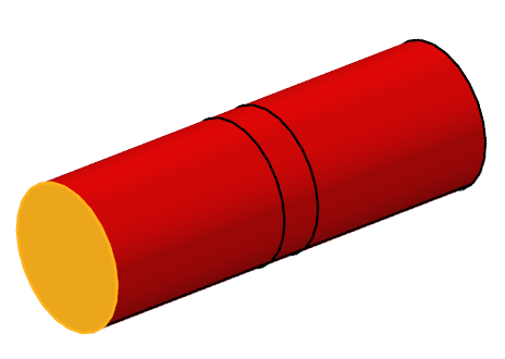

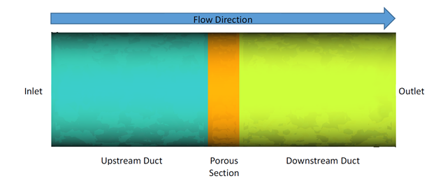

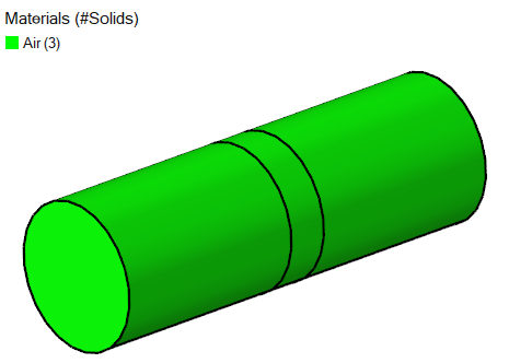

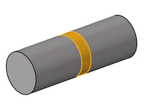

The problem to be addressed in this tutorial is shown schematically in the figure below. It consists of a cylindrical channel with a porous medium in the flow section. As the flow passes through this section, a pressure drop is observed. In this simulation, an inlet velocity will be assigned to the flow and pressure drop across the porous medium will be calculated. The length of the porous section is 0.06 m and the fluid is an imaginary air-like fluid with a density of 1 kg/m3 and a molecular viscosity of 0.001 kg/m-s. The inlet velocity of the flow is 0.2 m/s.

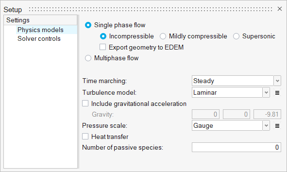

Set Up Flow

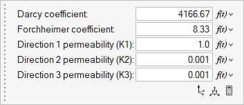

Define the Porous Medium

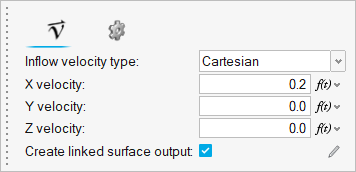

Assign the Flow Boundary Conditions

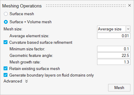

Generate the Mesh

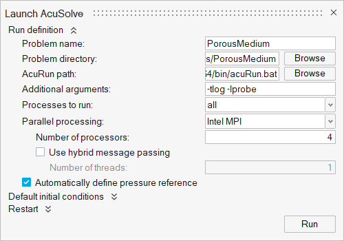

Run AcuSolve

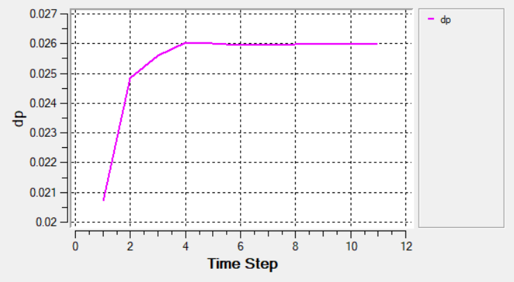

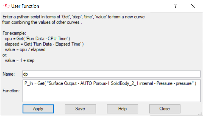

Post-Process the Results with AcuProbe

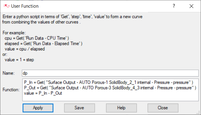

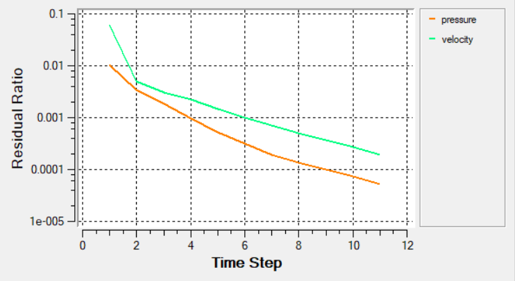

As the solution progresses, AcuProbe is launched automatically. AcuProbe can be used to monitor different variables over solution time. In this step, you will plot the residual ratio values and then compute the pressure drop across the porous section.
Summary
In this tutorial, you learned how to set up and solve a flow simulation with porous medium. You started by importing the HyperWorks CFD input database and then you defined the porous medium. Next, you assigned the flow boundary conditions and generated the mesh. Once the solution was computed, you created a plot of the pressure drop across the porous section using AcuProbe.
