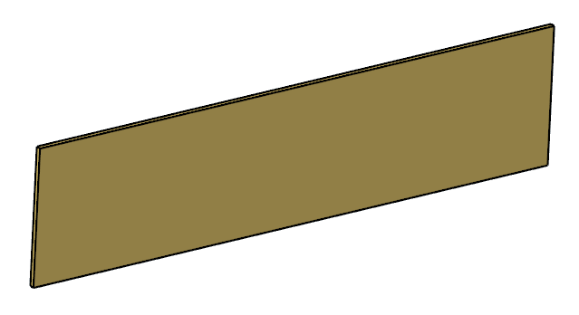

Import the Geometry
Validate the Geometry

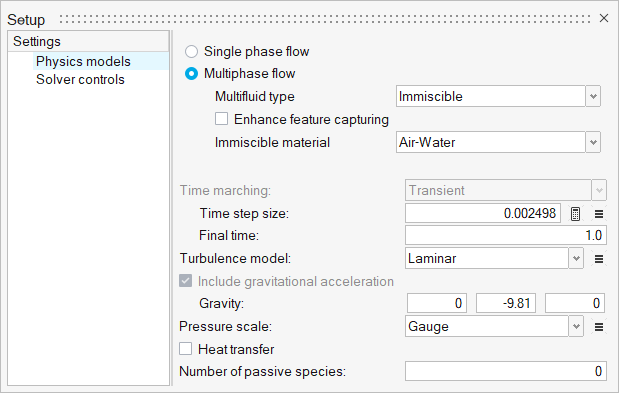

Set Up the Problem

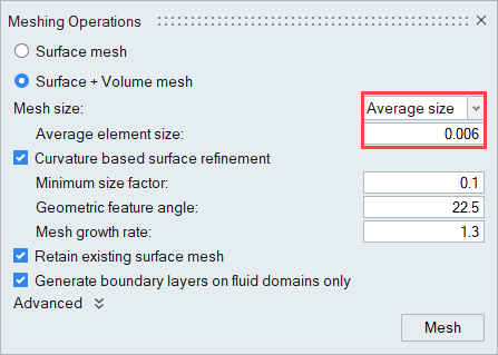

In this step, first you will create a surface mesh using the Interactive meshing tool; then, you will specify a global mesh size and growth rate for the model and generate the volume mesh using the Batch tool in the Mesh ribbon.
Create Surface Mesh
Generate Volume Mesh

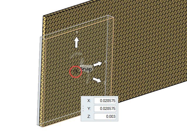

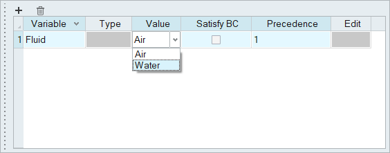

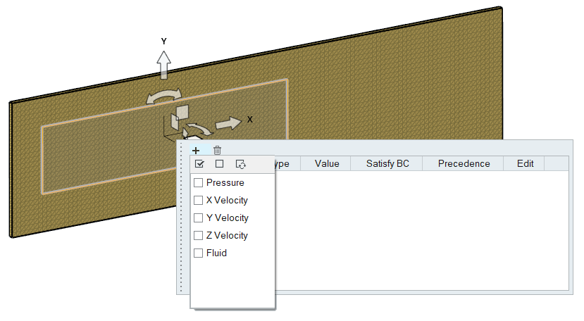

Define the Nodal Initial Conditions
