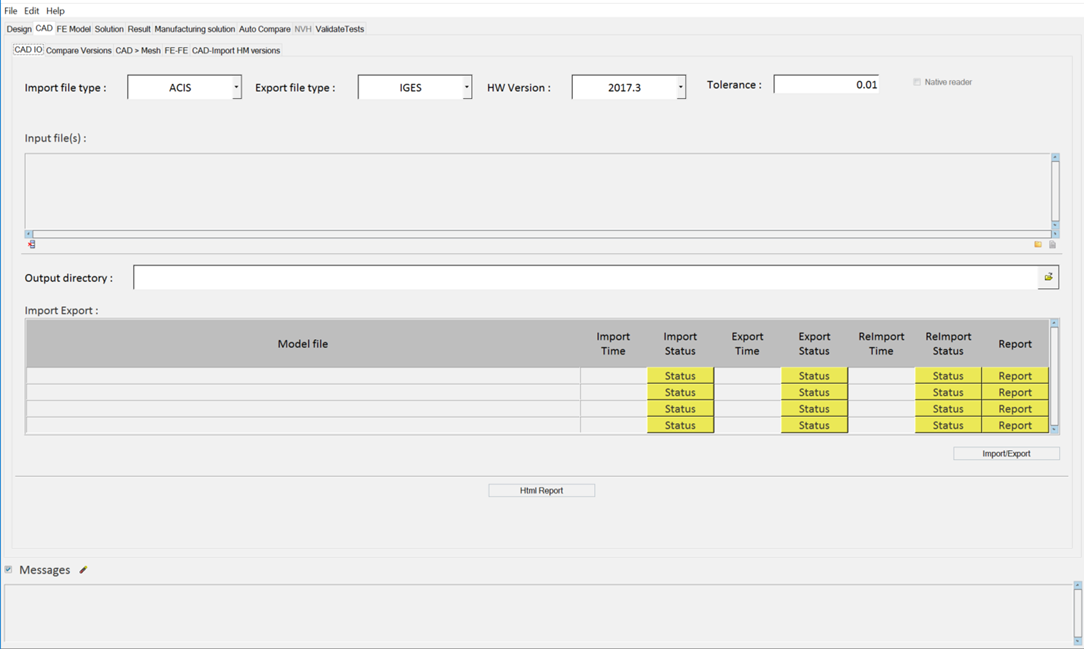

The native CAD model is imported into HyperMesh and exported using CAD readers in HyperMesh that are run in the background. The exported model is re-imported and overlaid. With superposed models using advanced CAD-CAD comparison, any loss of geometric data is identified, along with any entity changes. A reference report is also created.
- The message log file displays the current status of processes in progress. Click Status/Diff to display the respective report. The message log file is a text file and is saved to your output directory.
- Click Html Report to generate an HTML report of your session information for any number of files run through the process.
