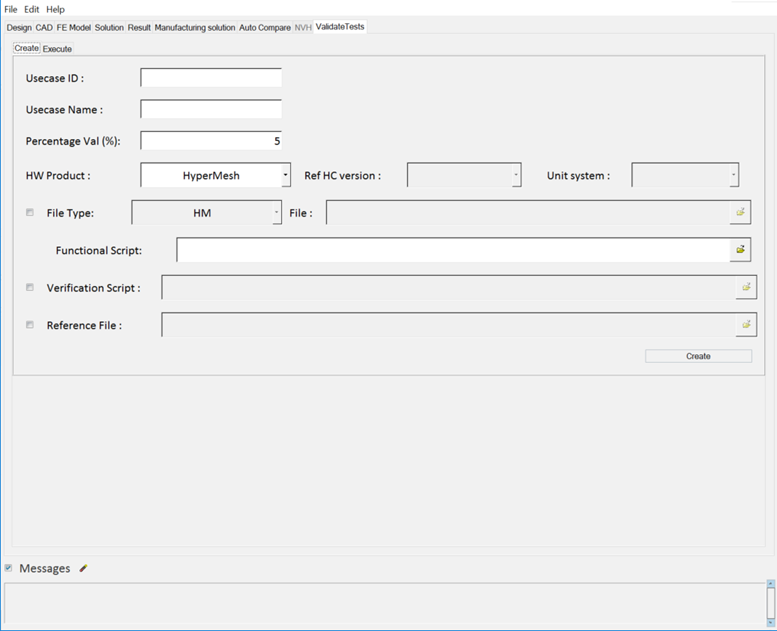

Create
Manually registers use cases from the Execute tab.
- Usecase ID
- Specify the usecase ID, used for registering use cases in the Execute tab.
- Usecase Name
- Specify the usecase name, used for registering use cases in the Execute tab.
- Percentage Tol (%)
- Specify the percentage tolerance value, used for output file comparison in the default diff engine (solverdiff).
- HW Product
- From the HW Product drop-down menu, select a product type: HyperMesh, HyperView, HyperGraph, or HyperCrash.
- Ref HC version
- This option is enabled when HyperCrash is selected from the HW Product menu.
- Unit system
- Enabled when HyperCrash is selected from the HW Product menu.
- Functional Script
- Write your own set of operations and scripts. Rules and formatting details are documented below.
- Verification Script
- Write your own script for output file comparison. Rule and formatting details are documented below.
- Reference File
- Activate the checkbox to enable the browse option. Click the file folder icon to browse and select the reference file.
- Create
- Click Create to register the use cases in the Execute tab.

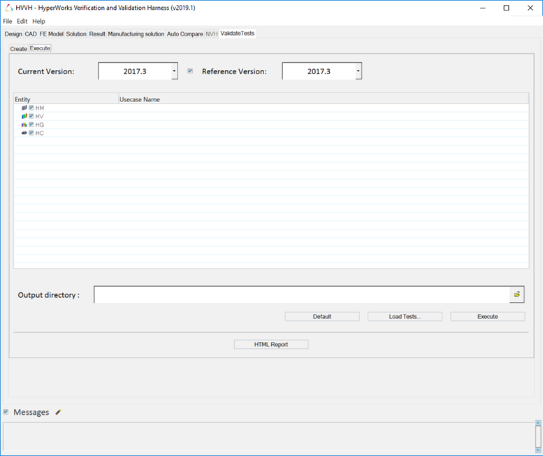

Execute
- Use the Create option (explained above)
- Use the Catalog file option (Default and Load Test... buttons)
- Current Version
- From the Current Version drop-down menu, select the HyperWorks version.
- Reference Version
- The Reference Version is ON by default (checkbox activated). From the Reference Version drop-down menu, select the HyperWorks version.
- Output directory
- Click the file folder icon,
, to select the output directory to store
your results. - Default
- Click Default to load the default catalog file from the installation.
- Load Tests…
- Click Load Tests… to display a file selection browser to select to the catalog file.
- Execute
- Click Execute to execute the functional script in the HyperWorks versions and compare the output files.
- Message log file
- A dynamically created message log file displays the status of the processes in progress. The message log file is a text file and is saved to your output directory.
- HTML Report
- Generates an HTML report of your session information for any number of files run through the process.
