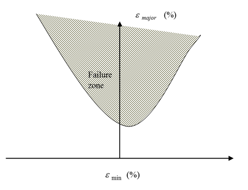

Forming Limit Diagram for Failure (FLD)
In this method the failure zone is defined in the plane of principal strains (Figure 1). The method usable for shell elements allows introducing the experimental results in the simulation.
Figure 1. Generic Forming Limit Diagram (FLD)

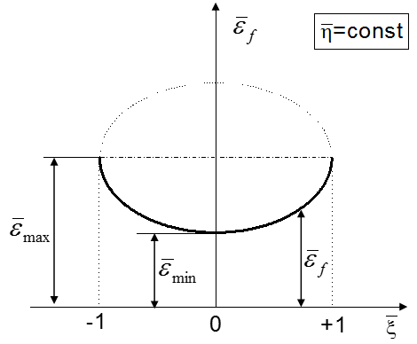

Bao-Xue Wierzbicki Failure Model
Bao-Xue-Wierzbicki model 5 represents a 3D fracture criterion which can be expressed by:(6)
ε ¯ f n = ε ¯ max n −[ ε ¯ max n − ε ¯ min n ] ( 1− ξ ¯ m ) 1/m MathType@MTEF@5@5@+= feaagKart1ev2aqatCvAUfeBSjuyZL2yd9gzLbvyNv2CaerbuLwBLn hiov2DGi1BTfMBaeXatLxBI9gBaerbd9wDYLwzYbItLDharqqtubsr 4rNCHbGeaGqiVu0Je9sqqrpepC0xbbL8F4rqqrFfpeea0xe9Lq=Jc9 vqaqpepm0xbba9pwe9Q8fs0=yqaqpepae9pg0FirpepeKkFr0xfr=x fr=xb9adbaqaaeGaciGaaiaabeqaamaabaabaaGcbaGafqyTduMbae badaWgaaWcbaGaamOzaaqabaGcdaahaaWcbeqaaiaad6gaaaGccqGH 9aqpcuaH1oqzgaqeamaaBaaaleaaciGGTbGaaiyyaiaacIhaaeqaaO WaaWbaaSqabeaacaWGUbaaaOGaeyOeI0YaamWaaeaacuaH1oqzgaqe amaaBaaaleaaciGGTbGaaiyyaiaacIhaaeqaaOWaaWbaaSqabeaaca WGUbaaaOGaeyOeI0IafqyTduMbaebadaWgaaWcbaGaciyBaiaacMga caGGUbaabeaakmaaCaaaleqabaGaamOBaaaaaOGaay5waiaaw2faam aabmaabaGaaGymaiabgkHiTiqbe67a4zaaraWaaWbaaSqabeaacaWG TbaaaaGccaGLOaGaayzkaaWaaWbaaSqabeaacaaIXaGaai4laiaad2 gaaaaaaa@596C@
(7)
ε ¯ max = C 1 e − C 2 η ¯ MathType@MTEF@5@5@+= feaagKart1ev2aqatCvAUfeBSjuyZL2yd9gzLbvyNv2CaerbuLwBLn hiov2DGi1BTfMBaeXatLxBI9gBaerbd9wDYLwzYbItLDharqqtubsr 4rNCHbGeaGqiVu0Je9sqqrpepC0xbbL8F4rqqrFfpeea0xe9Lq=Jc9 vqaqpepm0xbba9pwe9Q8fs0=yqaqpepae9pg0FirpepeKkFr0xfr=x fr=xb9adbaqaaeGaciGaaiaabeqaamaabaabaaGcbaGafqyTduMbae badaWgaaWcbaGaciyBaiaacggacaGG4baabeaakiabg2da9iaadoea daWgaaWcbaGaaGymaaqabaGccaWGLbWaaWbaaSqabeaacqGHsislca WGdbWaaSbaaWqaaiaaikdaaeqaaSGafq4TdGMbaebaaaaaaa@4303@
(8)
ε ¯ min = C 3 e − C 4 η ¯ MathType@MTEF@5@5@+= feaagKart1ev2aqatCvAUfeBSjuyZL2yd9gzLbvyNv2CaerbuLwBLn hiov2DGi1BTfMBaeXatLxBI9gBaerbd9wDYLwzYbItLDharqqtubsr 4rNCHbGeaGqiVu0Je9sqqrpepC0xbbL8F4rqqrFfpeea0xe9Lq=Jc9 vqaqpepm0xbba9pwe9Q8fs0=yqaqpepae9pg0FirpepeKkFr0xfr=x fr=xb9adbaqaaeGaciGaaiaabeqaamaabaabaaGcbaGafqyTduMbae badaWgaaWcbaGaciyBaiaacMgacaGGUbaabeaakiabg2da9iaadoea daWgaaWcbaGaaG4maaqabaGccaWGLbWaaWbaaSqabeaacqGHsislca WGdbWaaSbaaWqaaiaaisdaaeqaaSGafq4TdGMbaebaaaaaaa@4305@
Where, C 1 , C 2 , C 3 , C 4 , γ and m MathType@MTEF@5@5@+= feaagKart1ev2aqatCvAUfeBSjuyZL2yd9gzLbvyNv2CaerbuLwBLn hiov2DGi1BTfMBaeXatLxBI9gBaerbd9wDYLwzYbItLDharqqtubsr 4rNCHbGeaGqiVu0Je9sqqrpepC0xbbL8F4rqqrFfpeea0xe9Lq=Jc9 vqaqpepm0xbba9pwe9Q8fs0=yqaqpepae9pg0FirpepeKkFr0xfr=x fr=xb9adbaqaaeGaciGaaiaabeqaamaabaabaaWcbaGaamyBaaaa@36EA@ are the material constants, n is the hardening parameter and η ¯ and ξ ¯ are defined as:
  • for solids:
    If Imoy=0:
    η ¯ = σ m σ V M ; ξ ¯ = 27 2 J 3 σ V M 3
    If Imoy=1:
    η ¯ = ∫ 0 ε p σ m σ V M d ε p ε p ξ ¯ = ∫ 0 ε p 27 J 3 2 σ V M 3 d ε p ε p
  • for shells:
    η ¯ = σ m σ V M ; ξ ¯ = − 27 2 η ¯ ( η ¯ 2 − 1 3 )
Where,
σ m
Hydrostatic stress
σ V M
The von Mises stress
J 3 = s 1 s 2 s 3
Third invariant of principal deviatoric stresses
Figure 2. Graphical Representation of Bao-Xue-Wierzbicki Failure Criteria

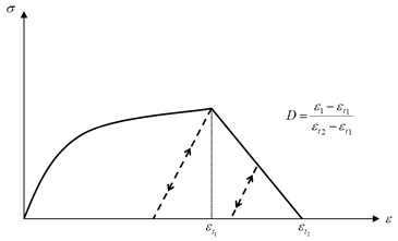

Strain Failure Model
This failure model can be compared to the damage model in LAW27. When the principal tension strain ε 1 reaches ε t 1 , a damage factor D MathType@MTEF@5@5@+= feaagKart1ev2aqatCvAUfeBSjuyZL2yd9gzLbvyNv2CaerbuLwBLn hiov2DGi1BTfMBaeXatLxBI9gBaerbd9wDYLwzYbItLDharqqtubsr 4rNCHbGeaGqiVu0Je9sqqrpepC0xbbL8F4rqqrFfpeea0xe9Lq=Jc9 vqaqpepm0xbba9pwe9Q8fs0=yqaqpepae9pg0FirpepeKkFr0xfr=x fr=xb9adbaqaaeGaciGaaiaabeqaamaabaabaaGcbaGaamiraaaa@36C0@ is applied to reduce the stress, as shown in Figure 3. The element is ruptured when D MathType@MTEF@5@5@+= feaagKart1ev2aqatCvAUfeBSjuyZL2yd9gzLbvyNv2CaerbuLwBLn hiov2DGi1BTfMBaeXatLxBI9gBaerbd9wDYLwzYbItLDharqqtubsr 4rNCHbGeaGqiVu0Je9sqqrpepC0xbbL8F4rqqrFfpeea0xe9Lq=Jc9 vqaqpepm0xbba9pwe9Q8fs0=yqaqpepae9pg0FirpepeKkFr0xfr=x fr=xb9adbaqaaeGaciGaaiaabeqaamaabaabaaGcbaGaamiraaaa@36C0@ =1. In addition, the maximum strains ε t 1 and ε t 2 may depend on the strain rate by defining a scale function.

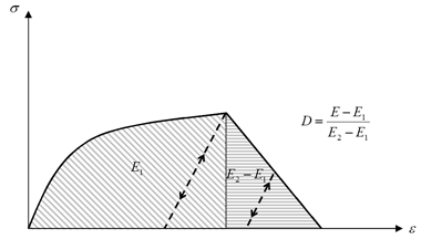

Specific Energy Failure Model
When the energy per unit volume achieves the value E 1 , then the damage factor D MathType@MTEF@5@5@+= feaagKart1ev2aqatCvAUfeBSjuyZL2yd9gzLbvyNv2CaerbuLwBLn hiov2DGi1BTfMBaeXatLxBI9gBaerbd9wDYLwzYbItLDharqqtubsr 4rNCHbGeaGqiVu0Je9sqqrpepC0xbbL8F4rqqrFfpeea0xe9Lq=Jc9 vqaqpepm0xbba9pwe9Q8fs0=yqaqpepae9pg0FirpepeKkFr0xfr=x fr=xb9adbaqaaeGaciGaaiaabeqaamaabaabaaGcbaGaamiraaaa@36C0@ is introduced to reduce the stress. For the limit value E 2 , the element is ruptured. In addition, the energy values E 1 and E 2 may depend on the strain rate by defining a scale function.
