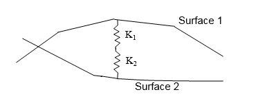

The TYPE3 interface spring stiffness K is determined by both surfaces. To retain solution stability, stiffness is limited by a scaling factor which is user defined on the input card. The default value (and recommended value) is 0.2.
The overall interface spring stiffness is determined by considering two springs acting in series.
Figure 3. Interface Springs in Series
The equation for the overall interface spring stiffness is:(1) K = s K 1 K 2 K 1 + K 2

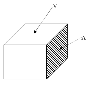

Brick Element
If the main interface segment is a set of brick elements, the stiffness is calculated by:(3) K = 0.5 s B A 2 V
Where,
B MathType@MTEF@5@5@+= feaagKart1ev2aaatCvAUfeBSjuyZL2yd9gzLbvyNv2CaerbuLwBLn hiov2DGi1BTfMBaeXatLxBI9gBaerbd9wDYLwzYbItLDharqqtubsr 4rNCHbGeaGqiVu0Je9sqqrpepC0xbbL8F4rqqrFfpeea0xe9Lq=Jc9 vqaqpepm0xbba9pwe9Q8fs0=yqaqpepae9pg0FirpepeKkFr0xfr=x fr=xb9adbaqaaeGaciGaaiaabeqaamaabaabaaGcbaGaam4Caaaa@36EE@
Bulk modulus
A MathType@MTEF@5@5@+= feaagKart1ev2aaatCvAUfeBSjuyZL2yd9gzLbvyNv2CaerbuLwBLn hiov2DGi1BTfMBaeXatLxBI9gBaerbd9wDYLwzYbItLDharqqtubsr 4rNCHbGeaGqiVu0Je9sqqrpepC0xbbL8F4rqqrFfpeea0xe9Lq=Jc9 vqaqpepm0xbba9pwe9Q8fs0=yqaqpepae9pg0FirpepeKkFr0xfr=x fr=xb9adbaqaaeGaciGaaiaabeqaamaabaabaaGcbaGaam4Caaaa@36EE@
Segment area
V MathType@MTEF@5@5@+= feaagKart1ev2aaatCvAUfeBSjuyZL2yd9gzLbvyNv2CaerbuLwBLn hiov2DGi1BTfMBaeXatLxBI9gBaerbd9wDYLwzYbItLDharqqtubsr 4rNCHbGeaGqiVu0Je9sqqrpepC0xbbL8F4rqqrFfpeea0xe9Lq=Jc9 vqaqpepm0xbba9pwe9Q8fs0=yqaqpepae9pg0FirpepeKkFr0xfr=x fr=xb9adbaqaaeGaciGaaiaabeqaamaabaabaaGcbaGaam4Caaaa@36EE@
Element volume
Figure 4. Brick Element

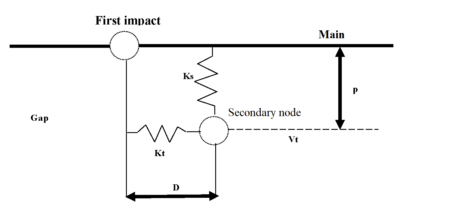

Figure 6. Friction on Interface TYPE3
The normal force computation is given by:(5) F n = K s P
Where,
K s = K 0 ( G a p G a p − P )
K 0
Initial interface spring stiffness (as in TYPE5)
The tangential force computation is given by:(6) F t = K t D
Where, K t = K n 10 .
If the friction force is greater than the limiting situation, | F t | > μ | F n | , the frictional force is reduced to equal the limit, | F t | = μ | F n | , and sliding will occur. If the friction is less than the limiting condition, F t ≤ μ F n , the force is unchanged and sticking will occur.
Time integration of the frictional forces is performed by:(7) F → t n e w = F → t o l d + Δ F → t
Where,
Δ F → t
Result from Equation 4
Figure 7. Friction on TYPE3 Interface

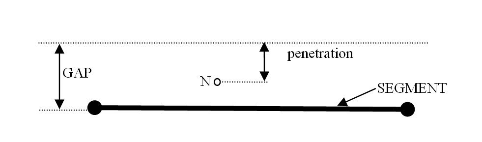

Interface Gap
TYPE3 interfaces have a gap that determines when contact between two segments occurs. This gap is user defined, but some interfaces will calculate an automatic default gap.
The gap determines the distance for which the segment interacts with the three nodes. If a node moves within the gap distance, such as nodes 1 and 2, reaction forces act on the nodes.
TYPE3 interface have a gap:
  • Only normal to the segment, as shown in Figure 8
  • On the contact side of the segments, which is defined by the surface normal. The size of the gap defined for certain interface types is critical. If the gap is too small, the solution time step may be dramatically reduced or a node may move across the entire gap in one time step. However, if the gap is too large, nodes not associated with the direct contact may become involved.
Figure 8. Interface Gap

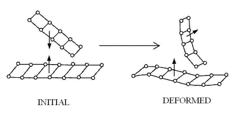

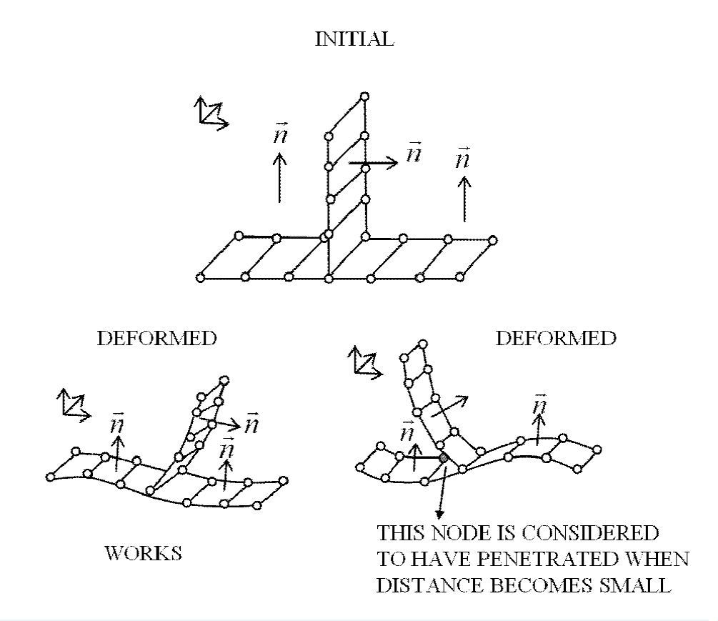

Care must be taken when defining contact surfaces with large deformation simulations. If the normal definitions of the contact surfaces are incorrect, node penetration will occur without any reaction from either surface.
Figure 9. Improper Normal Direction
Referring to Figure 9, the first situation shows the mesh deforming in a way that allows the normals to be facing each other. However, in the second case, the deformation moves two surfaces with normals all facing the same direction, where contact will not be detected. Large rotations can have a similar effect, as shown in Figure 10.
Figure 10. Initial and Deformed Mesh (Before Impact)
Kinematic motion may reposition the mesh so that normals do not correspond. It is recommended that possible impact situations be understood before a simulation is attempted.
