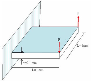

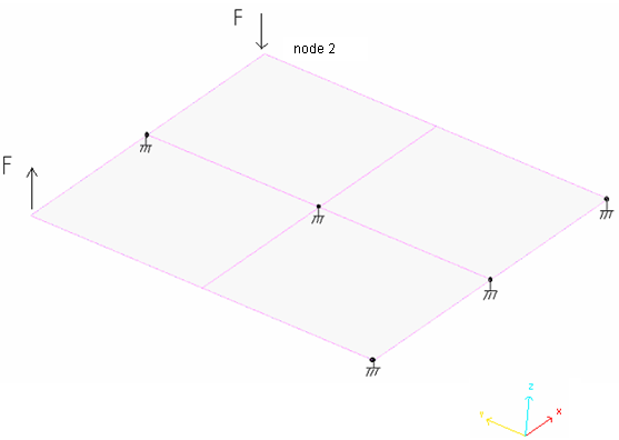

The boundary conditions are such that the three nodes of a single side and the two middle ones are blocked, while the others are free with respect to the Y axis.
- Concentrated loads (/CLOAD)Two concentrated loads are applied on the corner points of the opposite side. They increase over time as defined by the following function:
F(t) 0 10 10 t 0 200 400
Figure 1. Boundary Conditions and Loads - Element formulation (Properties)

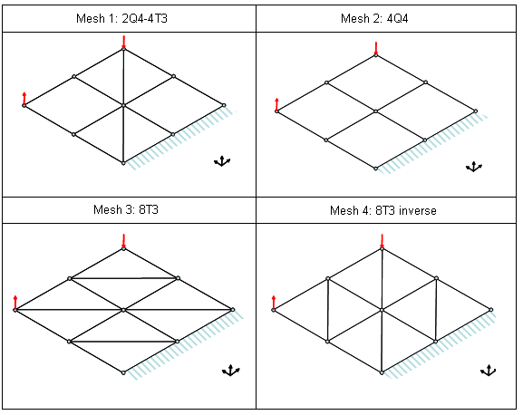

- Mesh 1
- Two quadrilateral shells and four triangular shells (2Q4-4T3)
- Mesh 2
- Four quadrilateral shells (4Q4)
- Mesh 3
- Eight triangular shells (8T3)
- Mesh 4
- Eight triangular shells (8T3 inverse)
- QBAT formulation (Ishell =12)
- QEPH formulation (Ishell =24)
- Belytshcko & Tsay formulation (Ishell =1 or 3, hourglass control TYPE1, TYPE3)
- C0 and DKT18 formulations
Figure 3. Square Plate Meshes

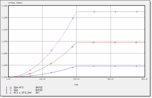

Energy Curves / Comparison for Element Formulations
Figure 4. Internal Energy for 2 x Q4 and 4 x T3 Elements
Figure 5. Internal Energy for 4 x Q4 Elements

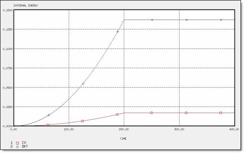

Figure 6. Internal Energy for 8 x T3 Elements
Energy Curves / Comparison for Mesh Definitions
Figure 7. Internal Energy for Different Meshes

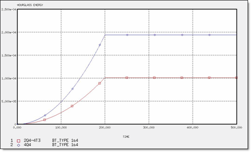

Figure 8. Hourglass Energy for Different Meshes
| 2 Q4- 4 T3 | 4 Q4 | 8 T3 | 8 T3 Inverse | |||||||||
| QEPH | BT_TYPE1 | BT_TYPE4 | BATOZ | QEPH | BT_TYPE1 | BT_TYPE4 | BATOZ | DKT | C0 | DKT | C0 | |
| IEmax | 2.74x10-2 | 2.35x10-2 | 2.37x10-2 | 7.21x10-2 | 3.64x10-2 | 2.93x10-2 | 2.97x10-2 | 2.30x10-2 | 1.37 x10-1 | 1.69x10-2 | 1.37x10-1 | 1.69x10-2 |
| HEmax | -- | 1.01x10-4 | 1.03x10-4 | -- | -- | 1.94x10-4 | 1.98x10-6 | -- | -- | -- | -- | -- |
| DZmax | 1.75x10-3 | 1.78x10-3 | 1.78x10-3 | 1.21x10-2 | 2.42x10-3 | 2.95x10-3 | 2.97x10-3 | 2.30x10-3 | 1.44x10-2 | 1.69x10-3 | 1.44x10-2 | 1.69x10-3 |
Conclusion
- For the 4Q4 mesh, the results obtained using QBATOZ and QEPH are similar. BT elements are too flexible and are not significantly influenced by the hourglass formulation, due to the in-plane mesh.
- For triangular meshes, the DKT element is able to bend much better, the co-element being too stiff.
