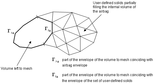

Some of these
finite volumes can be entered by you through a group of solids, located inside
the airbag and filling a part or the total internal volume. If there still
exists a part of the internal volume which is not discretized by user-defined
solids, an automatic meshing procedure produces the remaining volumes. This can
be used for example to model a canister.

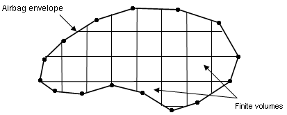

A finite volume consists in a set
of triangular facets. Their vertices do not necessarily coincide with the nodes
of the airbag. The airbag envelope can be modeled with 4-node or 3-node
membranes; however, 3 nodes are recommended. Figure 1. Figure 2.

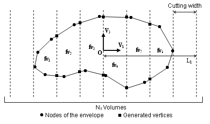

Automatic finite volume
meshing parameters.
The finite volumes are
generated in two steps.
The first step generates vertices lying exclusively on the envelope of the
airbag. You can update the finite volume along with the deformation of the
envelope and correspond to the following procedure (displayed in 2D for
purpose of clarity): Figure 4.
This procedure requires the input of the direction , named cutting direction, and of the
direction . A second direction in the plan normal to the cutting
direction will be computed. In order to position the finite volumes and
to determine the cutting width in both direction and , an origin O must be
provided as well as a length
Li, counted
both positively and negatively from the origin, and a number of steps
Ni. The cutting
width is then given by:(11)
It is required that the box drawn in the
horizontal plane (normal to ) by the origin O and
the length Li, counted
both positively and negatively from O, includes the bounding-box of the
envelope of the volume to mesh projected in this plane. This is
necessary to ensure that this volume in entirely divided into finite
volumes.

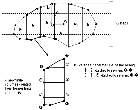

The second step performs horizontal cutting of the finite volumes, and may
be useless in many cases of tightly folded airbags. It is required
especially when injection is made in a canister filled by the injected gas
before unfolding the airbag.
