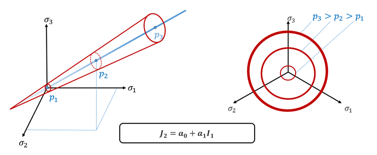

- Original Drücker-Prager
yield criterion has a linear pressure dependency.

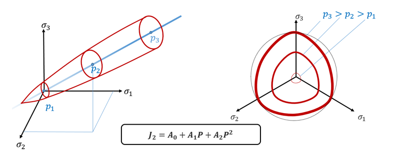

Figure 1. Original Drücker-Prager Yield CriteriaRadioss is using the extended Drücker-Prager yield criteria whose pressure dependency is nonlinear.

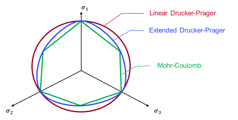

Figure 2. Extended Drücker-Prager Yield Criteria Implemented in Radioss - Extended Drücker-Prager
yield criteria can be compared with Mohr-Coulomb criteria.

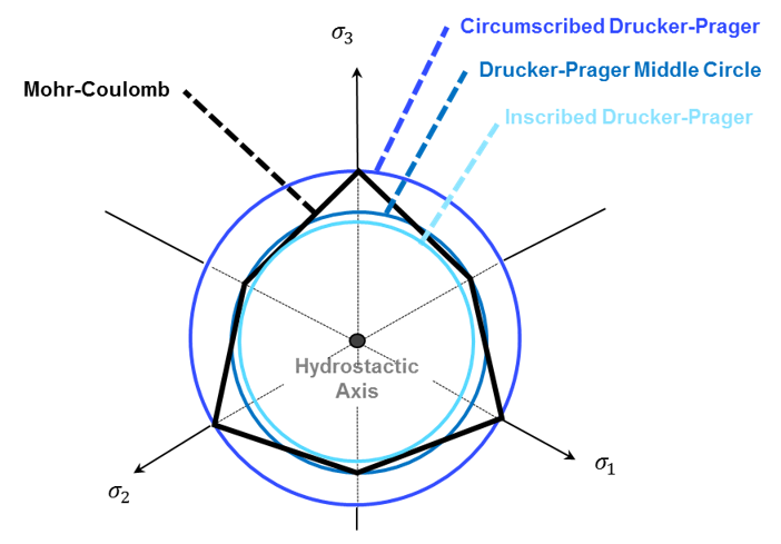

Figure 3. Extended Drücker-Prager Yield Criteria Implemented in Radioss versus Mohr-Coulomb CriteriaAn extended Drücker-Prager yield criterion can be fitted from Mohr-Coulomb parameters:- Cohesion parameter
- Angle of internal friction
For this purpose, parameters must be defined as:(1) - Modeling Type
- Parameters
- Circumscribed Drücker-Prager criteria
- Middle Circle
- Inscribed Drücker-Prager criteria
