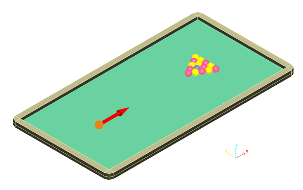

- Initial velocities (/INIVEL)

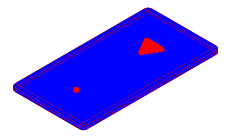

Figure 1. Initial Translational Velocities of the Impacting Ball
All nodes of the lower face of the table are completely fixed (translations and rotations).

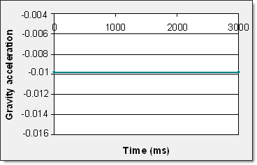

Figure 2. Gravity Function (-0.00981 mm.ms-2 )

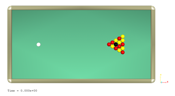

Model Description

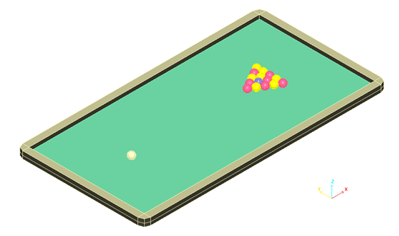

Figure 3. Pool Game
Units: mm, g, N, MPa.
- Material Properties: Balls (pheonolic resin)
- Initial density
- 0.00137 g.mm-3
- Young's modulus
- 10500
- Poisson ratio
- 0.3

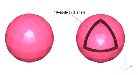

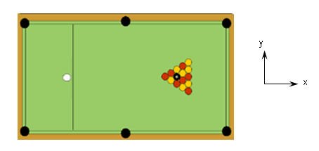

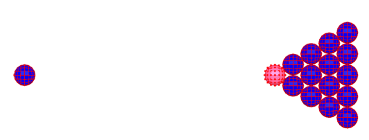

Figure 4. Pool Game Mesh
Figure 5. Mesh for Balls
Figure 6. 16-node Thick Shell Element
Figure 7. TYPE16 Interface: Secondary SHEL16 for Balls and Main SHEL16 for the Table
Figure 8. Example of the TYPE16 Interface Defined for the Contact Between Balls

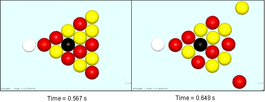

Figure 9.
Figure 10. Collision of the Balls
