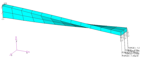

MacNeal-Harder Test This is a twisted cantilever beam solved with solid and shell elements. A model is made with each element's type to investigate the effect of distorted elements with a high aspect ratio.
Benchmark Model
Six types of elements are used for this problem. They are tria-shell, quad-shell, and hexa-solid elements, each with 1st and 2nd order. Two loading cases are used for each model; in-plane bending, transverse bending. For both load cases, unit loads are applied in a consistent fashion over all of the nodes at the tip of the beam.
