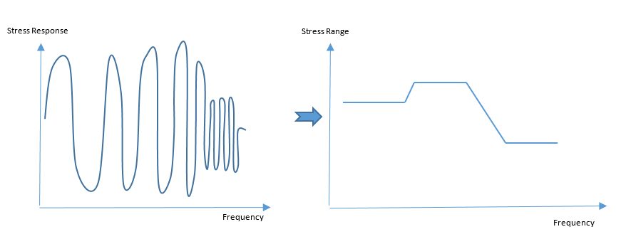

Figure 1. Varying Amplitude Stress Data with Increasing Frequency

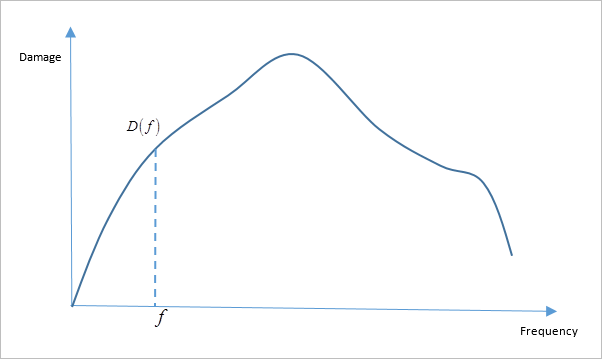

Figure 2. Damage vs Frequency: Area Under this Curve is the Total Damage Per Sweep
Based on the damage per cycle at a frequency, D c y c ( f ) , a curve of Damage vs Frequency is constructed. This is constructed by first calculating the Damage per frequency:(4) D( f )= D cyc ( f )* n f cyc

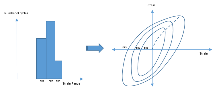

Since loading and unloading path information is lost in vibration analysis, the strain-life approach in vibration fatigue is a conservative extension of the stress-range based data.
Strain-life fatigue analysis is typically conducted for situations where plastic strain is encountered. In such cases, the greatest energy loss (largest stress-strain hysteresis loop) occurs for the cycle with largest strain range. Since this is the largest strain range, the damage is also the highest for this one cycle compared to the rest of the lower strain-range cycles. First, Neuber correction is applied to convert Stress-Range data to Strain-Range data.

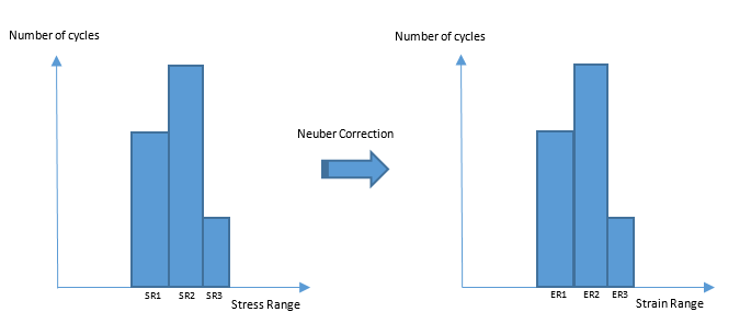

Figure 3. Neuber Correction: Histogram Bar Graph for Cycles vs Stress Range Converted to Cycles vs Strain Range
Based on Figure 3, you can see that the stress range SR3 leads to the ER3 Strain range which leads to maximum damage and also the largest stress-strain hysteresis loop. All other stress-strain hysteresis curves will lie inside this curve, since they will cause lower damage and have lower strain energy loss compared to the highest cycle.
Figure 4. Strain-Range Histogram Illustrated as Stress-Strain Hysteresis Loops
Note: Zero mean stress is considered for EN Sine sweep fatigue. Therefore, the stress-strain curves are symmetric about the stress and strain axes for all strain ranges.

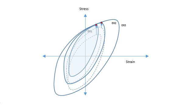

For strain-life sine sweep fatigue, the strain ranges for each of the inner hysteresis loops are based on corresponding stress range values at which the loading was applied. These loops are now pushed upward until the top of the loops touch the largest loop (this process is known as hanging). Similarly, this process is repeated for all inner loops until all loops touch the corresponding topmost point of the largest hysteresis loop.
Figure 5. Hanging Lower Strain-Range Hysteresis Loops to the Largest Hysteresis Loop
