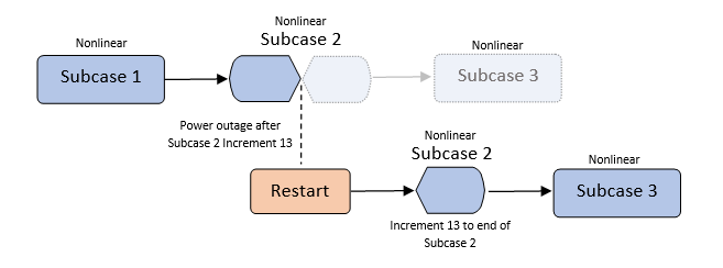

- Restart from the last point at which the initial run was interrupted (for
example, due to a power outage).
Example:
If a 3-subcase model with RESTARTW was interrupted due to power outage during the solution of subcase 2, after the 13th increment, the following can be added to the model to restart it.RESTARTR = originaljob_sub2_inc0013This will restart the model from the interruption point (end of increment 13), and the load history of Subcase 2 from increment 13 will be continued.

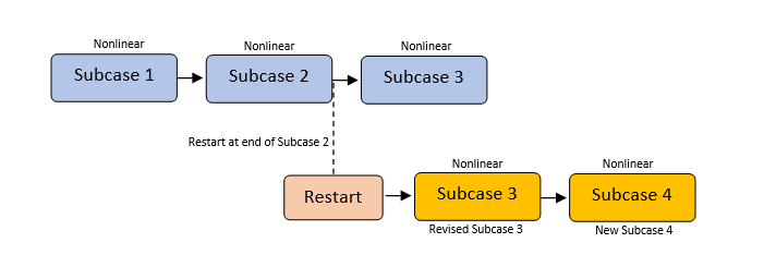

Figure 1. Example: Restart after a Power Outage - Restart from some point of a successful nonlinear analysis and append new
nonlinear subcases in continuation.
Example:
If a 3-subcase model with RESTARTW completed successfully, but now you want to replace subcase 3 with a different subcase and also add a new subcase 4. Then you can revise the 3-subcase model by adding subcase 4 and make required changes to subcase 3.
If the final increment of subcase 2 is increment 21, use:RESTARTR = originaljob_sub2_inc0021This will restart the model from the end of subcase 2 (beginning of subcase 3) and both revised subcase 3 and new subcase 4 will be run.

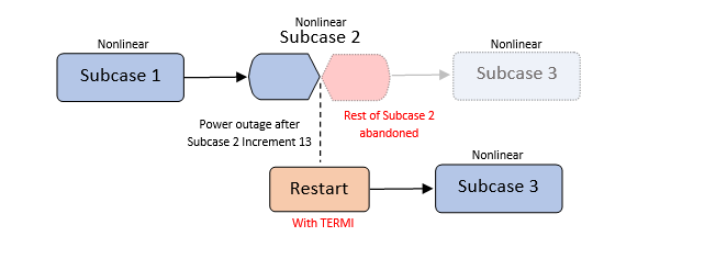

Figure 2. Example: Revise an Existing Subcase and Append a New Subcase - Restart from some point of a nonlinear analysis, truncate the nonlinear
subcase at that point and append new nonlinear subcases in continuation.
(This can be accomplished using the TERMI option on
RESTARTR Bulk Data Entry).
Example:
If a 3-subcase model with RESTARTW was interrupted after the 13th increment of Subcase 2. If you want to restart the run, but now you want to discard the rest of the load history of subcase 2, from the restart point, then use the TERMI option.
If the increment at which the subcase 2 was terminated is increment 13, use:RESTARTR = TERMI,originaljob_sub2_inc0013This will abandon the remaining load history from the restarting point for subcase 2, and subcase 3 will now append to the restarting point. So subcase 3 is now a different loading path.
When TERMI is specified, OptiStruct will abandon the remaining load history from the restarting point (original run). And then append new loading history continuing from the restarting point in the restart run.
Figure 3. Example: Abandon Remainder of Subcase 2 after a Power OutageFor the 3-subcase example, assuming the load histories (in total time) are:
1st Subcase → [0 – 1s], 2nd Subcase → [1 – 2s] and 3rd Subcase → [2 – 3s].
If the run gets terminated at 1.3s of 2nd subcase, with TERMI, the remaining load history from [1.3s – 2s] for subcase 2, will be abandoned. And subcase 3 will now append to the restarting point (1.3s) and then [1.3 – 2.3s] is the range of total time for the restarted subcase 3. This subcase 3 is now essentially a different loading path (with original loading of subcase 3, but starting from nonlinear state/restarting point of 1.3s).
If TERMI is not specified, OptiStruct will continue to finish [1.3 – 2s] of subcase 2 and then continue to [2 – 3s] of subcase 3.
The restart analyses with and without TERMI generally lead to different loading paths and different results.

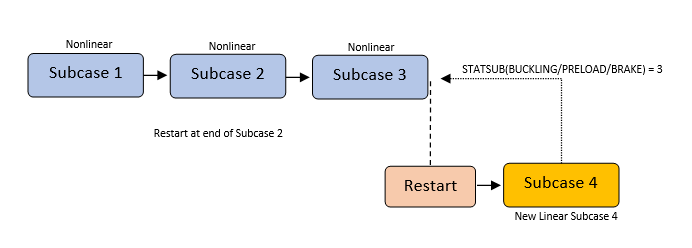

linear
STATSUB(BUCKLING/PRELOAD/BRAKE)
subcases. The linear
subcases should reference the ending nonlinear subcase.
Example:
If a 3-subcase model with RESTARTW completed successfully, but now you want to add a new subcase 4, which is a Linear subcase with STATSUB(BUCKLING/PRELOAD/BRAKE).
If the final increment of subcase 3 is increment 25, use:RESTARTR = originaljob_sub3_inc0025
Figure 4. Example: Append a Linear Subcase with STATSUBThis will restart the model from the end of subcase 3 (beginning of subcase 4) and the new subcase 4 (linear subcase) will be run.Note: In this case, the STATSUB entry in linear subcase 4 should point to the final nonlinear subcase in the chain (which is subcase 3 for this example).
