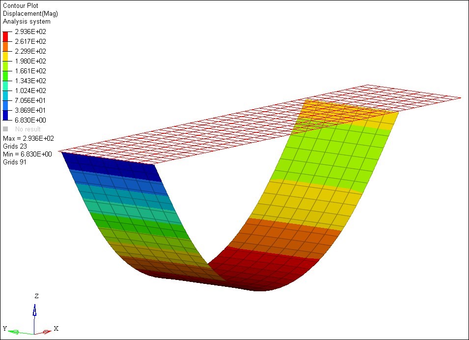

Figure 1. Nonlinear Large Displacement Subcase Solution for Model A

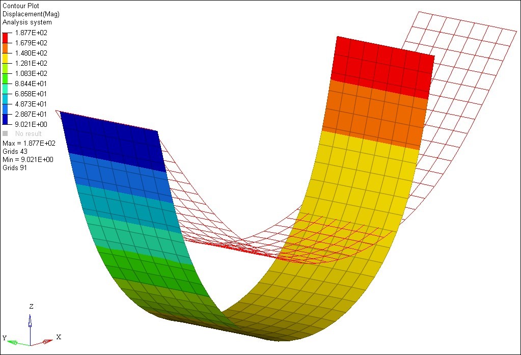

Figure 2. Linear Subcase Solution with Nonlinear Large Displacement Subcase as Preload for Model A
The maximum displacement of 293.5 is observed for the node 23 for the nonlinear large displacement subcase and a maximum displacement of 187.7 mm for the subsequent linear subcase.

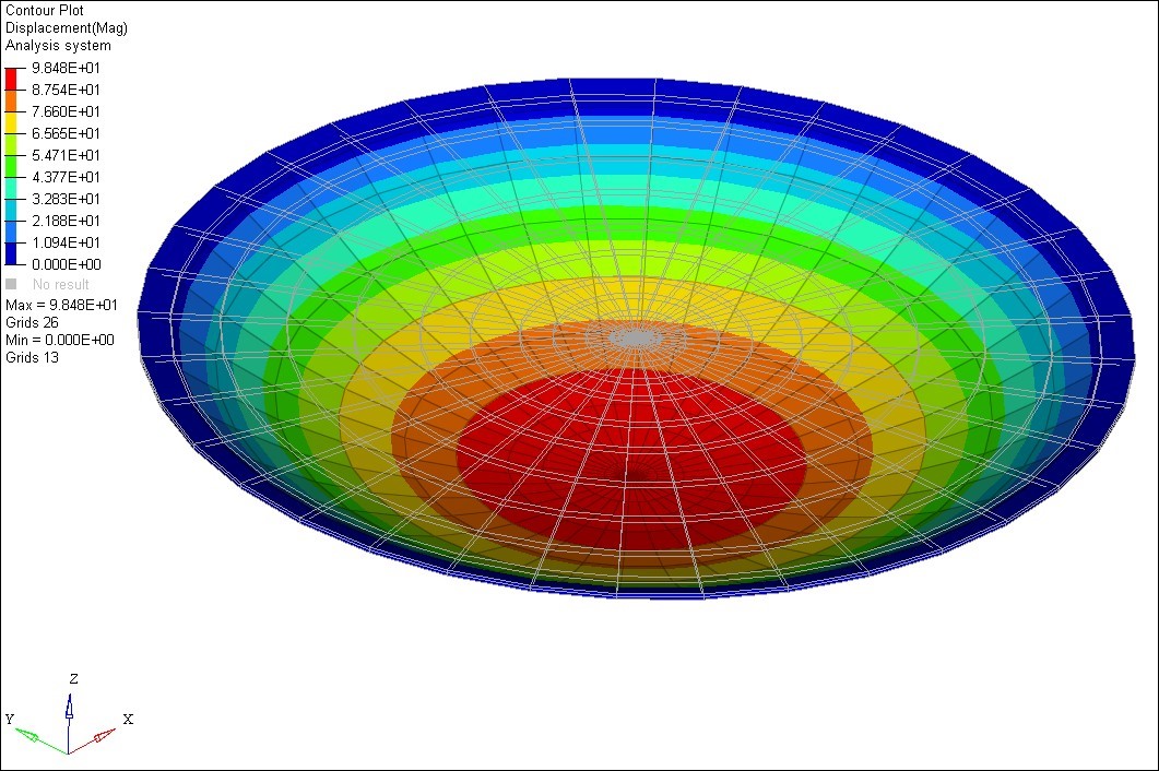

Figure 3. Nonlinear Large Displacement Subcase Solution for Model B

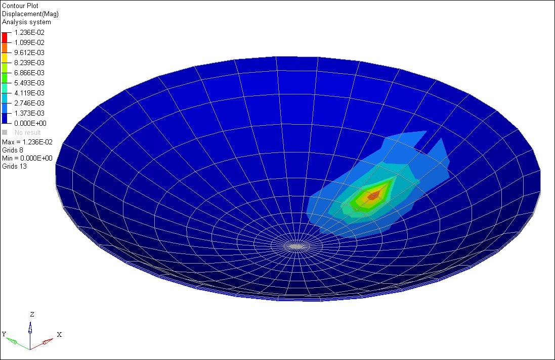

Figure 4. Modal Frequency Response Subcase Solution with Nonlinear Large Displacement Subcase as Preload for Model B
