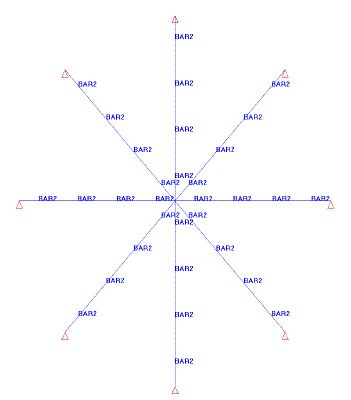

Benchmark Model
The 2-node simple beam elements are used to model the double cross. Each arm of the cross consists of four elements. The x- and y-translation displacements are fixed at the end of all arms.
- E
- 200 x 109 N/m2
- 8000 kg/m3
