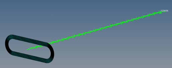

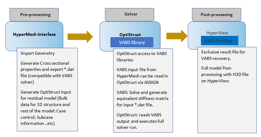

The HyperMesh interface has special utility to generate a finite element mesh of the cross section including all the details of geometry and material as inputs to calculate the sectional properties including structural properties and inertial properties. VABS compatible input file is saved at a prescribed working directory. The unified work flow further enables to generate OptiStruct input deck for the residual model in the same HyperMesh session.
Figure 1. High Level Workflow

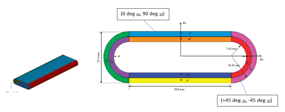

Figure 2. Composite Pipe
- E11 = 141.693
- E22 = E33 = 9.79056 (GPa)
- G12 = G23 = G31 = 5.99844e9 (GPa)
- = = = 0.42

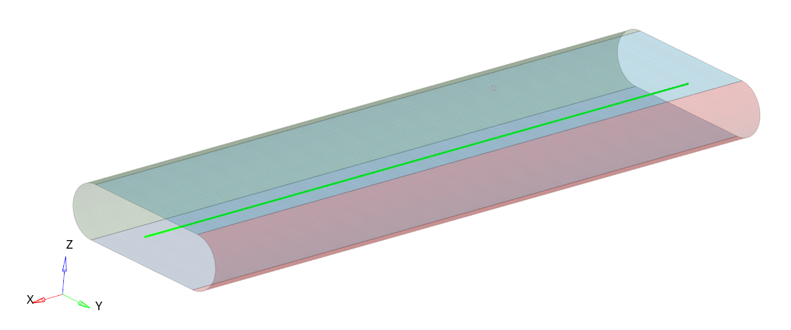

Figure 3. 1D (CBEAM) Elements Aligned with the x-axis Center of the Composite Pipe
Launch HyperMesh and Set the Profiles
The model shown in Figure 3 is used in this exercise. The 2D (SHELL) mesh and 1D (CBEAM) elements are already idealized.

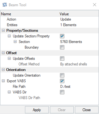

Update Section Properties for VABS and Create *.dat File
The special utility is opened to create the section properties for the given cross-section and export VABS input file to the working directory.

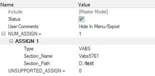

Review Cross-section Property and ASSIGN Card
- In the Model Browser, expand the Properties folder.
- Right-click on Beam_ID_Vabs_5761_Prop.
Click Card Edit to review the Group and Type of the
PBEAML.
- In the Model Browser, expand Cards folder.
- Right-click on ASSIGN.
In the Entity Editor, verify:

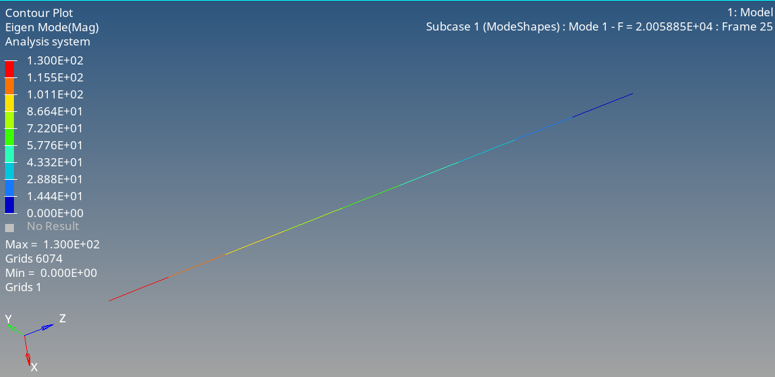

Review the Results
OptiStruct automatically invokes the VABS executables and runs the *.dat file to generate equivalent stiffness matrix. OptiStruct reads VABS output and executes full solver run.
