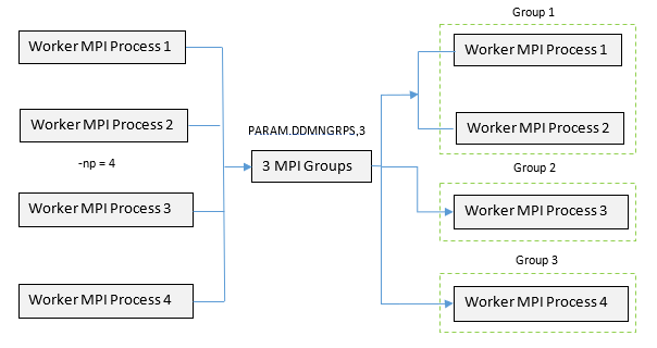

Figure 1. Example DDM Setup with Four MPI Processes (
-np
=4) which are divided into 3 groups. This is an example of how grouping can be accomplished to parallelize a

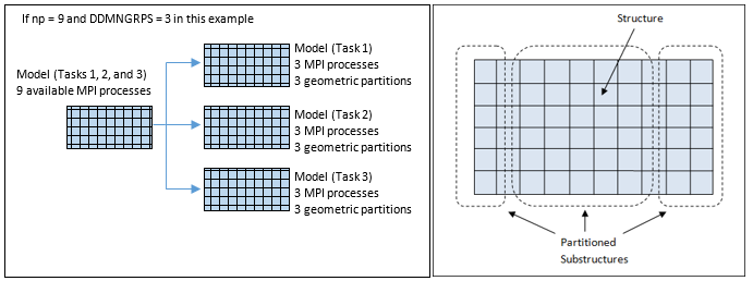

Figure 2. (a) DDM Level 1: Parallelization of Tasks; (b) DDM Level 2: Geometric Partitioning of each Task-based Models. depending on the number of MPI processes and number of MPI groups

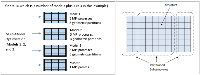

Figure 3. (a) DDM Level 1: Parallelization of MMO Models; (b) DDM Level 2: Geometric Partitioning of Some or all of the MMO Optimization Models. depending on the number of MPI processes and number of MPI groups

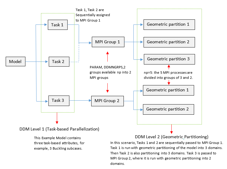

Figure 4. Example DDM Setup with 5 MPI Processes (
-np
=5) . The model has 3 task attributes (Example, 3 buckling subcases, or 3
DFREQ loading frequencies, etc). PARAM,
DDMNGRPS,2 is defined

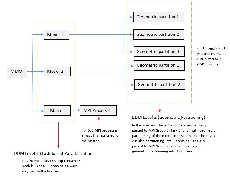

Figure 5. Example DDM Setup with 6 MPI Processes (
-np
=6). The MMO setup has 2 models. PARAM,DDMNGRPS should not
be used in conjunction with MMOThe DDM functionality for level two parallelization is direct geometric partitioning of a model based on the number of MPI processes available in the MPI group that is assigned to this task.

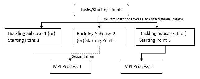

Figure 6. Example of 3 Buckling Subcase Model (or 3 Starting Points in DGLOBAL). First Level of DDM Parallelization:
-np
2
-ddm
with
PARAM,DDMNGRPS,MAX
(assign geometric partitions/starting points to DDM MPI processes,
sequentially)

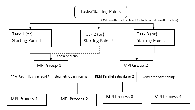

Figure 7. Example of 3 Buckling Subcase Model (or 3 Starting Points in DGLOBAL). Hybrid DDM with 2 Levels of Parallelization
-np
4
-ddm
, and
PARAM,DDMNGRPS,2
(assigns 3 Buckling subcases/starting points to DDM MPI groups,
sequentially. Subsequently, geometric partitioning is done within each MPI Solution | Activation | Level 1 | Level 2 | Grouping |

Multi-Model Optimization (MMO) with DDM | Use -np #
-mmo PARAM,DDMNGRPS is not supported with MMO |
Optimization models are parallelized wherein extra MPI
processes (> no of models plus 1) are distributed evenly to
models in mainr MMO file (or user- defined -np
for each model in main file). |
Any MMO optimization model is geometrically partitioned and solved in parallel (number of partitions depends on number of MPI processes/np assigned to it). | There is no grouping via PARAM,DDMNGRPS as it is not supported for MMO. However, grouping is indirectly accomplished by automatic distribution of np to the MMO models or by explicit user input via Main file. |
