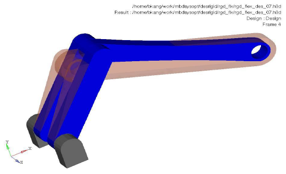

Figure 3. Opaque Orange: Base Line Model; Blue: Optimized Model
