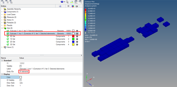

- SET of distorted elements at the current
iteration/increment

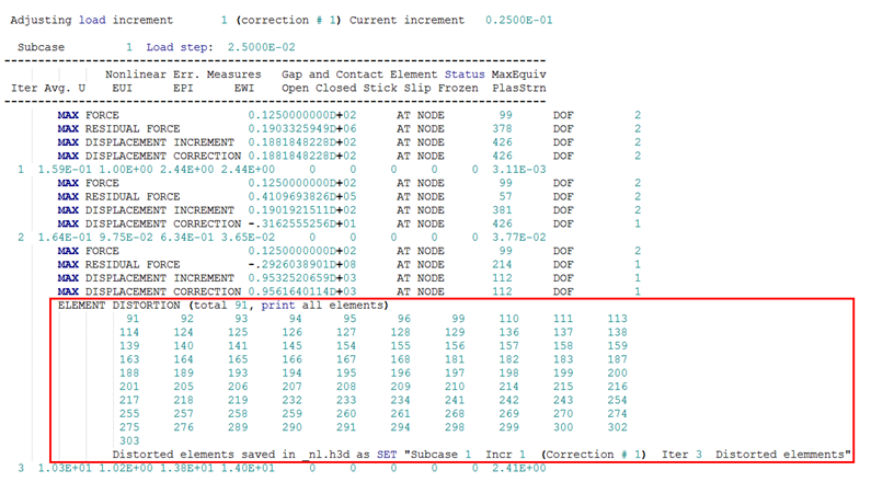

The distorted element SET name can be correlated with the corresponding printing in the _nl.out file. For instance, see the printing corresponding to the same example in the _nl.out file.

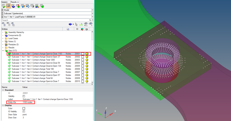

Figure 2. - SET of grids associated with Contact Status Change at the
current iteration/incrementFigure 3 illustrates an example SET of grids which are associated with a contact status change from Open to Close in the _nl.h3d file.

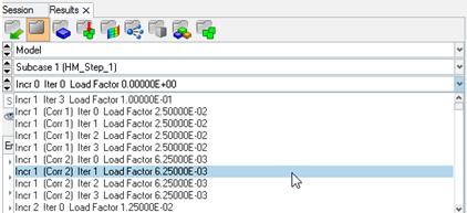

- For each load step, the following
information is also printed in the labels in the Results Browser pull-down menu (Figure 4):
- The increment number
- The correction number at the current increment
- The iteration number within a particular increment
- The load factor
