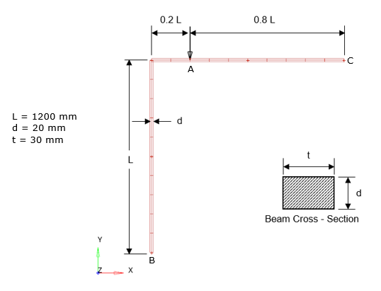

Figure 1. Model Details
Benchmark Model
The frame was meshed with first order CBAR elements of size 120 mm and a rectangular cross-section of 30 mm x 20 mm was assigned. The z-translational degree of freedom (DOF) was constrained using Single Point Constraints (SPCs) for all the nodes to prevent out of plane motion, while the x and y translational DOFs were constrained using SPCs for the end nodes. The frame was loaded along the negative y-direction with a load of P = 20 kN and the problem was solved using the Arc Length Method.

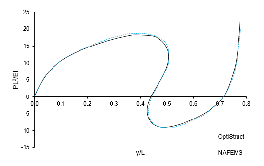

Figure 2. Comparison of Postbuckling Plot from OptiStruct with NAFEMS
- I
- Area moment of inertia of the beam
- y
- Vertical deflection

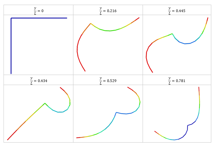

Figure 3. Deformation Plots
