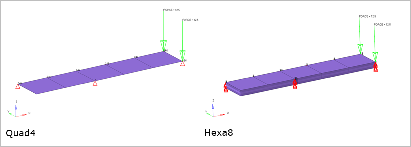

Quad4 and Hexa8 elements are used to create one quarter model of the laminated strip simply supported at A. For Quad4 elements Ply laminates are created and for Hexa8 elements PSOLID property is used. A line load of 10N/mm is applied at C.

Linear Static Analysis Results
| Target | OS Results | Normalized with the Target Value | |
| Laminated Plate (Quad4): | |||
| Bending Stress at E (MPa) | 683.9 | 570.196 | 1.19941213 |
| Interlaminar Shear Stress at D (MPa) | -4.1 | -4.103 | 0.99926883 |
| Z deflection at E (mm) | -1.06 | -1.045 | 1.01435407 |
| Stacked Brick (Hex8): | |||
| Bending Stress at E (MPa) | 683.9 | 572.81 | 1.19393865 |
| Interlaminar Shear Stress at D (MPa) | -4.1 | -3.229 | 1.26974295 |
| Z deflection at E (mm) | -1.06 | -1.028 | 1.0311284 |
