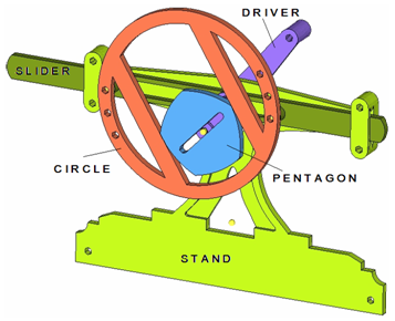

Figure 1. Rigid Body Model

There will be five bodies apart from the ground body in our model via: the stand, the slider, the driver, the pentagon and the circle. Pre-defined free nodes will be used to define the bodies and joints.

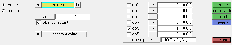

| Motion (rev) | 3 | 2 | 1 |

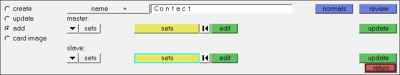

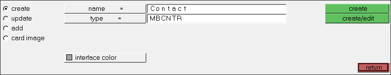

Define a Contact

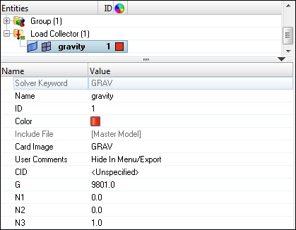

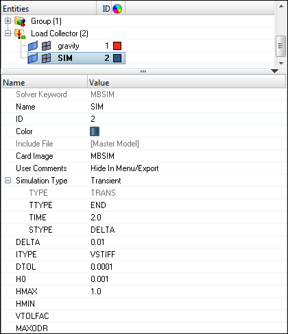

In this step you will create the gravity force that applies to the model and MBSIM Bulk Data card, which is to specify the parameter for multibody simulation.
