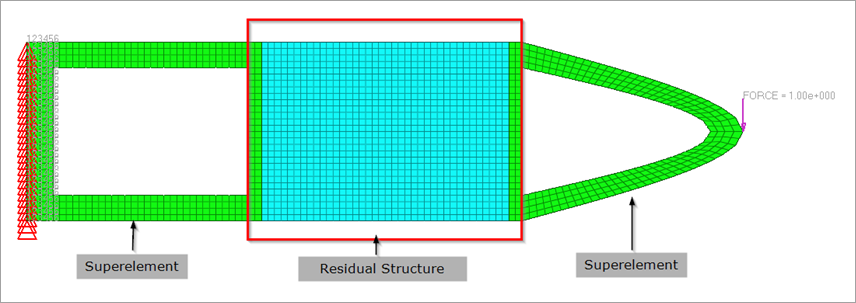

Figure 1. Selecting the Superelements and the Residual Structure
Solving models using superelements is different from the way you run other models in OptiStruct. Therefore, it is beneficial to initially understand a couple of basic terms typically utilized in these solutions.

Residual Structure
The part of the full model that remains after the superelement has been created is the Residual structure (or simply, Residual).

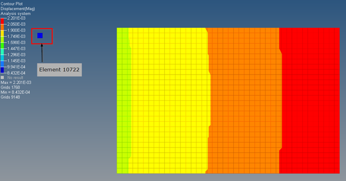

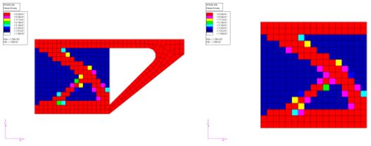

The following image illustrates the Displacement results of the Residual Structure (only) after the end of the residual run. The output data specified in the input decks is:
Figure 4. Generation Run
Figure 5. Residual Run
direct_matrix_displacement_results
Figure 6. Displacement Results of the Residual Structure (only)

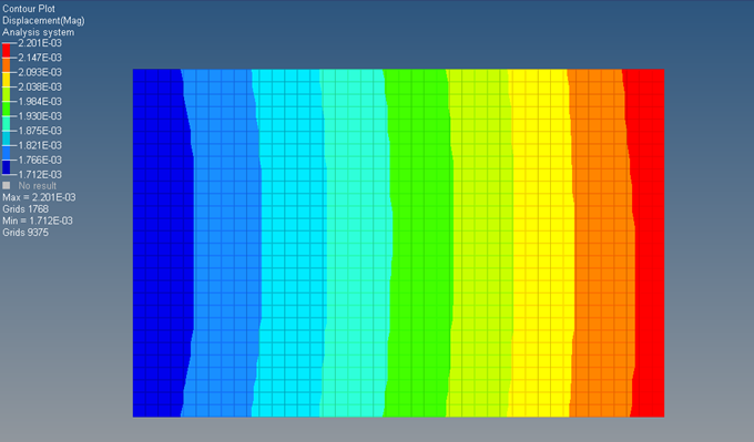

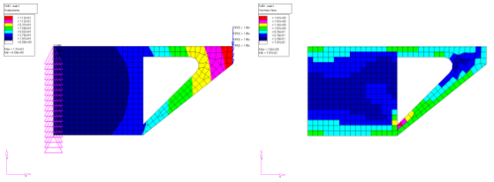

The following image illustrates the Displacement results of the Residual Structure and a set of grid points in the superelement after the end of the residual run. The generation run consists of MODEL data referencing element 10722 (SET 15) and the DISPLACEMENT entry references the grid points associated with element 10722 and some other grid points. You can see how only the results for the intersection of sets referenced by MODEL and the DISPLACEMENT entry is generated. The output data specified in the input decks is:
Figure 7. Generation Run
direct_matrix_resid_run_10722
Figure 8. Residual Run
direct_matrix_displacement_results_10722
Figure 9. Displacement Results of Residual Structure and Element 10722 in the Superelement
