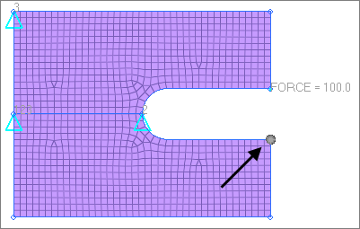

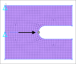

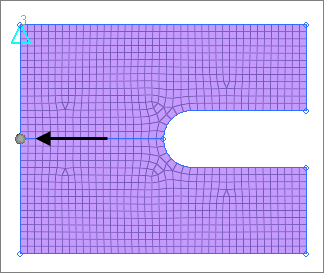

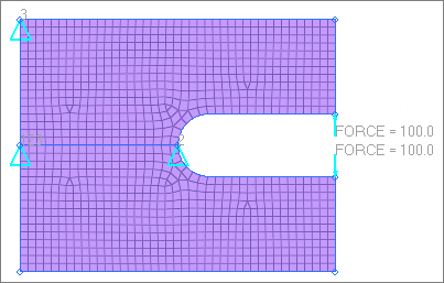

Apply Loads and Boundary Conditions
Create Load Collectors
Create Constraints
Create Forces

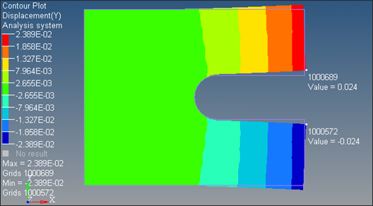

A linear static analysis of this C-clip is performed prior to the definition of the optimization process. An analysis identifies the responses of the structure before optimization to ensure that constraints defined for the optimization are reasonable.
View the Results

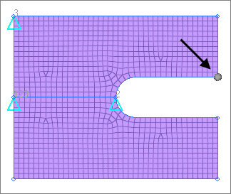

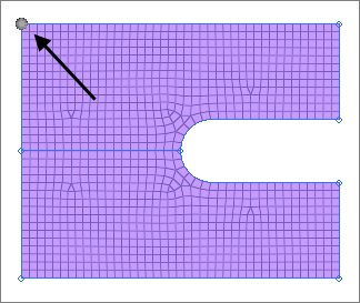

The forces in the structure are applied on the outer nodes of the opening of the clip, making those two nodes critical locations in the mesh where the maximum displacement is likely to occur. In this tutorial, you will apply a displacement constraint on the nodes so that they would not displace more than 0.07 in the y-axis.

Create the upper bound constraint.
- In the constraint= field, enter c_upper.
- Check the box next to upper bound, then enter 0.07.
- Click response= and select upperdis.
- Using the loadsteps selector, select opposing forces.
- Click create.
Create the lower bound constraint.
- In the constraint= field, enter c_lower.
- Check the box next to lower bound, then enter -0.07.
- Click response= and select lowerdis.
- Click create.

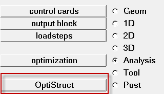

Create the SCREEN Card
- From the Analysis page, click control cards.
- In the Card Image dialog, click SCREEN.
- Click return.
- Click return.

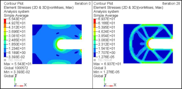

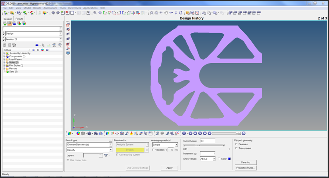

View the Results

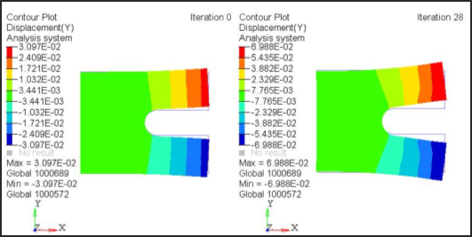

Element density results are output to the cclip_complete_des.h3d file from OptiStruct for all iterations. In addition, Displacement and Stress results are output for each subcase for the first and last iterations by default into cclip_complete_s#.h3d files, where # specifies the sub case ID.
