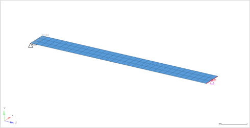

Figure 1. FE-Model with Boundary Conditions

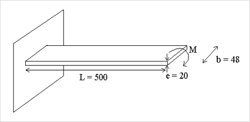

Figure 2. Geometry of the Problem
Model Description
This example has a simple cantilever beam with an end moment. The moment variation is modeled by introducing a constant imposed velocity on the free end. The moment is applied on a rigid body created at one end of the beam and on the other end all the DOF’s are blocked.
- Shell Elements
- First order Quad elements

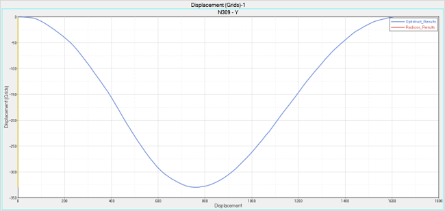

Results

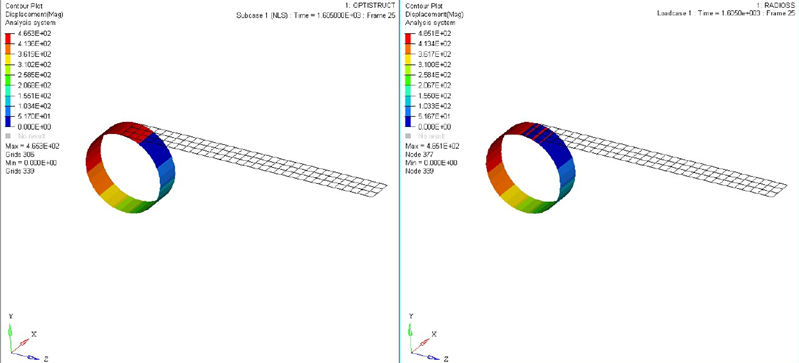

Figure 3.
Figure 4. OptiStruct on the Left; Radioss on the Right
