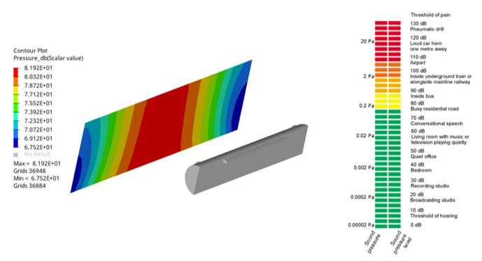

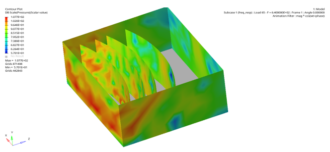

Everyone wants great, high-quality, loud but clear sound from their audio system that fills the room with a deep bass and clear treble. The sound quality should not cause changes when the volume is turned up, and you certainly want to avoid vibrations, static hiss to come out of the speakers.
FEA Model Description
Figure 1. Speakers Acoustic Model
Results
Figure 2. Pressure Intensity on the Receiver in db

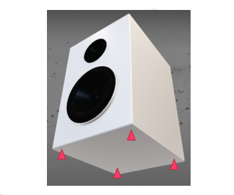

Figure 4. Speaker Model

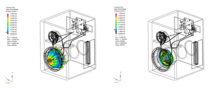

Figure 6. Modal Analysis - Model Setup
Results
Figure 7. Mode Shapes of the Speaker Membrane
Figure 8. Mode Shapes of the Cables

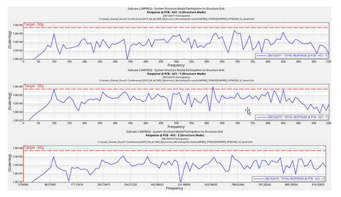

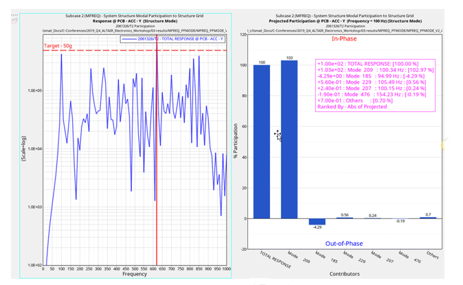

Frequency Response Analysis is performed on speakers to know the vibration levels of the speakers at different locations of the assembly. You can identify any violated targets, diagnose the root cause of the failures and then optimize to meet the target. Hence, use Frequency Response Analysis to catch any extreme vibrations and optimize the speaker design. OptiStruct provides an option (PFMODE) to check the modal participation factor for all modal frequency response subcases. In this way, you can see which structural modes contribute maximum towards the response of our target points.

Figure 11. Response of PCB in X, Y and Z Direction
Figure 12. Violated Target at Two Frequencies
Figure 13. Modal Participation Factors for the Response in Y Direction

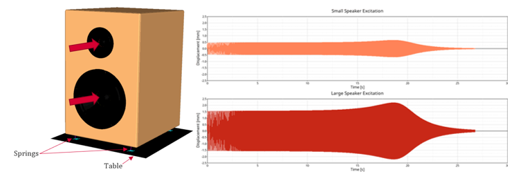

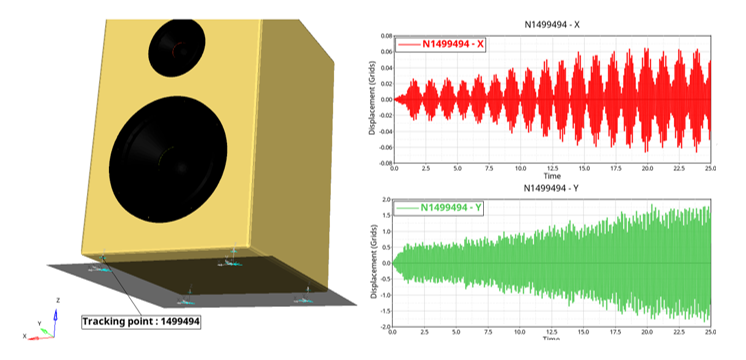

Here a Modal Transient Analysis in OptiStruct is performed to visualize the vibrating motion of the speaker assembly which is supported on springs.
Figure 14. Loading on the Speaker Assembly
Results
Figure 15. Displacement of Spring Elements

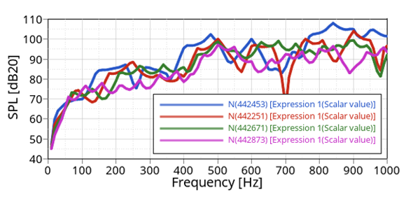

External Acoustic using Infinite Element Method: Use-Case
This method involves a smooth acoustic mesh (in this case, a sphere) around the structural mesh. The ends of the acoustic mesh are (surface of the acoustic sphere) have infinite elements.
Figure 16. Acoustic Mesh with Infinite Elements
Results

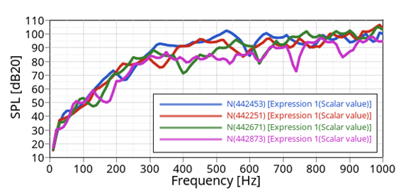

Figure 17. Pressure Plots for Two Microphone Points (N515956 and N515890)

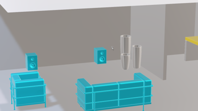

A speaker arrangement in a living room is showcased, where you query the sound pressure levels at different locations in the room and also check the effect of the speaker assembly rotation on the perceived sound pressure levels. Here, you will exemplify how OptiStruct offers an efficient platform to test the speakers in real-life settings versus against a lab setting (Physical tests), where the microphones are located only at pre-defined points.
Model Description
Figure 19. 15 Speaker Assembly in Living Room Setup

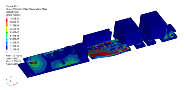

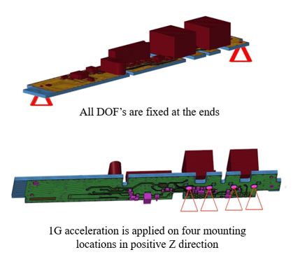

To analyze the critical area of PCB, first normal mode analysis is performed to calculate natural frequencies in the PCB.
Frequency Response Analysis Model Description
Figure 25. Frequency Response Analysis
Frequency Response Analysis Results
Figure 26. Maximum von Mises Stresses

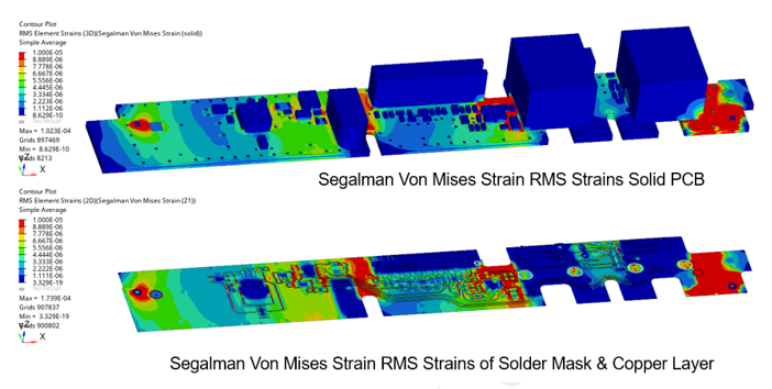

Random Response Analysis Use-Case
Random Response Analysis is performed using results from FRF and adding a power spectral density graph of amplitude versus frequency up to 10000 HZ.
Random Response Analysis Results
Figure 27. RMS Strains
