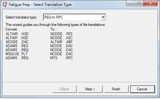

The form shows the set of file translations that are possible using the
Fatigue Prep Wizard.
From the drop-down menu, choose H3D to FES. Then click
Next.

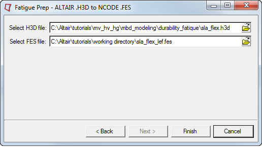

Specify the H3D file sla_flex.h3d, located in the
mbd_modeling\durability_fatigue folder.
Specify the FES file as <working
directory>\sla_flex_left.fes.
Figure 4. Fatigue Prep Wizard
Click Finish.
The Altair flexible body pre-processor is launched and the FES file is
created in your <working directory>.

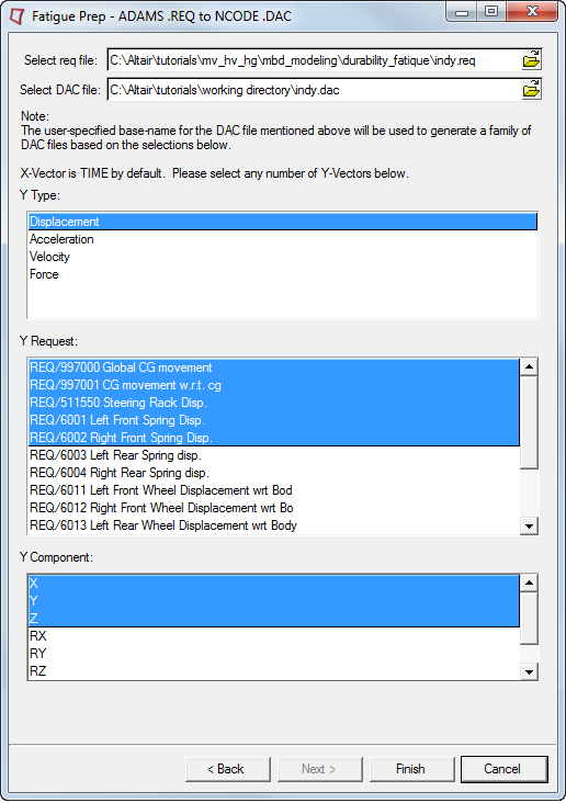

For Y Type, choose Displacement.
The Y request and Y components will automatically populate the next
fields.
Select the first five Y requests and the first three
Y components.
Figure 5. REQ to DAC translation
Note: You can select any number of Y requests and Y components for REQ2DAC
conversion.
Click Finish.
The message 'Translation complete' is displayed on the screen. MotionSolve generates 15 DAC files for each combination
selected.

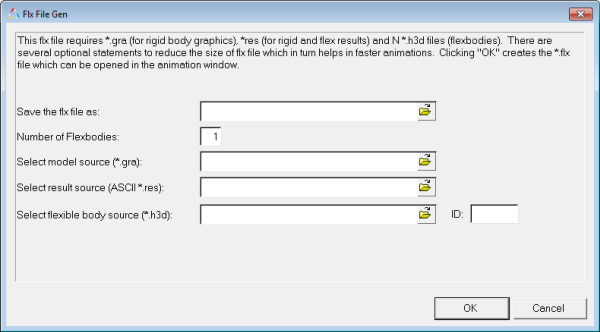

This displays the Flex File Generator dialog. The
dialog lists the files you will need for the conversion.
Use Save the *flx file as and specify the destination of
the file as <working-dir>\sla_flex.

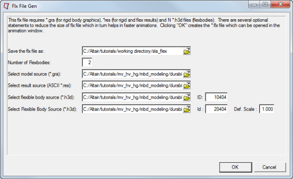

In the Number of Flexbodies field, enter 2 (the model
includes two lower control arms as flexible bodies).
Use the Select model source (*.gra) file browser to
select the sla_flex.gra file from the
Use the Select result source (ASCII *.res) file browser
to select sla_flex.res file from the
Use the first Select flexible body source (*.h3d) file
browser to select sla_flex.h3d file from the
Use the second Select flexible body source (*.h3d) file
browser to select sla_flex_m.h3d file from the
Under ID, enter 10404 and 20404
for the two H3Ds respectively.
These values should correspond to the actual IDs of the flexible bodies in the
ADM input deck of the ADAMS solver.
The
deformation of these flexible bodies during animation can be scaled using
the Def. Scale field. In this case, accept the default value of
1.000.
Figure 6.
Click OK.
This will launch the translator and create the FLX file in the
destination directory.
