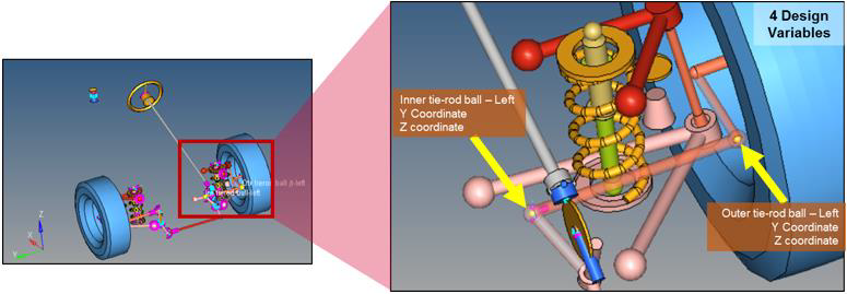

- In this tutorial, you will reproduce the suspension optimization problem in MV-3010 (Optimization using MotionView - HyperStudy). The location (y and z coordinates) of both inner tie-rod ball joint and outer tie-rod ball joint are changed so that the toe vs. ride height curve matches a given desired target curve.
Figure 1. Suspension Topology to Optimize

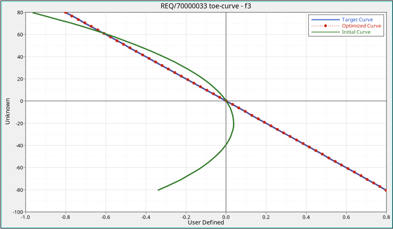

Figure 2. ‘Toe-ride height’ curve of initial design, optimized design and target design

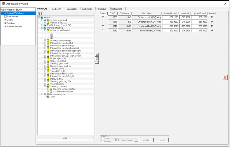

Add Design Variables
In this step, you will add design variables for the optimization.

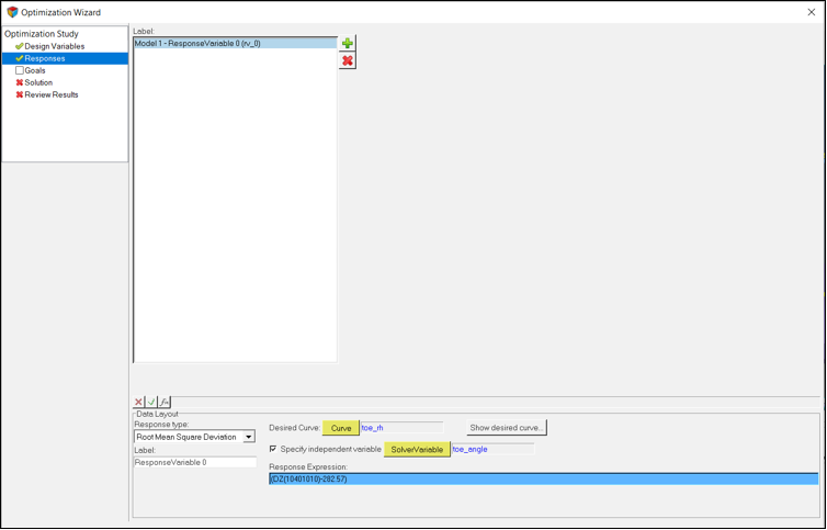

Add Response Variables
In this step, you will add response variables to the optimization.

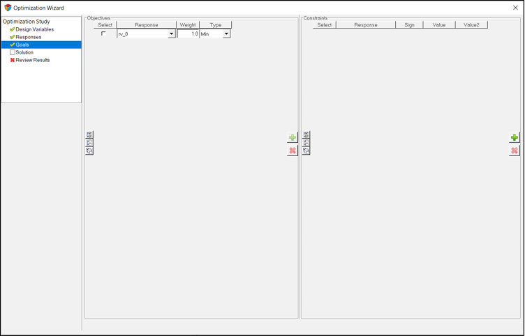

Add Objectives and Constraints
In this step, you will add an objective to the problem.
Figure 5. Defining objectives

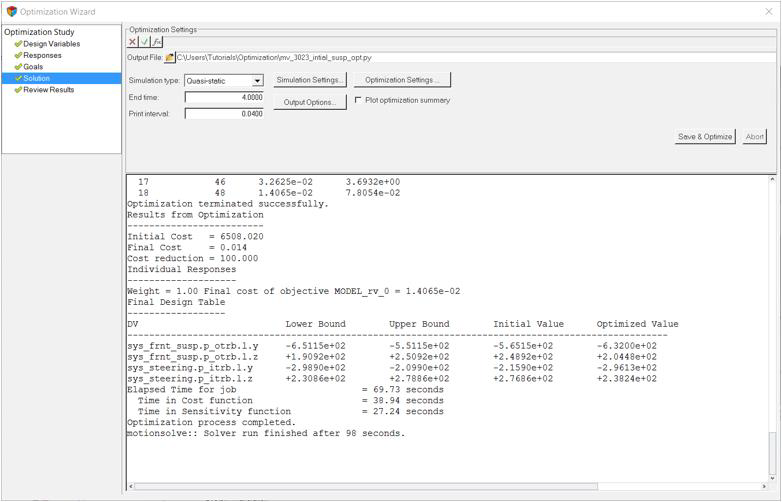

Run the Optimization
In this step, you will run the optimization.

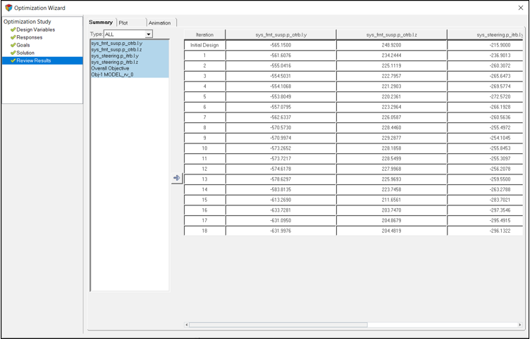

Post-Process
In this step, you will post-process the results of the optimization.
