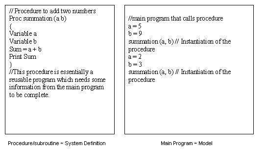

The concept of system definition is analogous to the procedures/subroutines in a programming language.
- Analogy between programming and MDL approach
- A procedure is a program that needs information from the main program. The
procedure can be called /instantiated any number of times. A procedure is a
part of main program, but can be maintained separately.
Similarly, a system definition is a model aggregate which needs information from the main model. It can be called/instantiated any number of times. A system definition is a part of the main model which can be maintained separately.

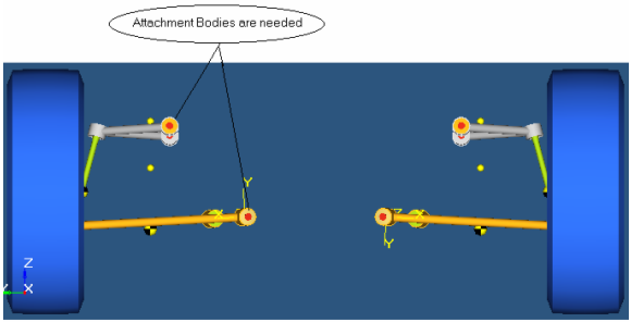

- The picture below shows a system definition of an SLA suspension. It is an
incomplete system which needs information about the attachment bodies and
points to get connected to.
Figure 2.Excluding the *Attachment() statement, other entities in a system definition are similar to an MDL model file.

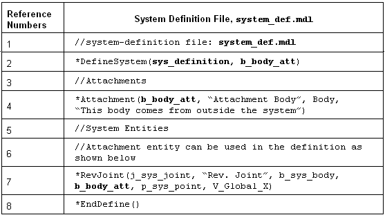

- Line 2 - defines a system with a variable name
sys_definitionand has one argumentb_body_attas an attachment. - Line 4 - declares
b_body_attas an attachment with the entity type as Body. - Line 7 - creates a revolute joint between
b_sys_bodywhich is a body defined within this system (not shown) andb_body_attwhich is a body that is an attachment to this system.
