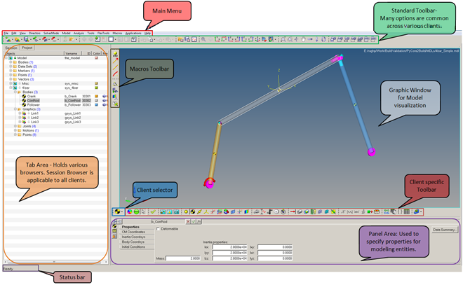

- The MotionView Interface
- MotionView is one of the clients that reside
under the HyperWorks Desktop (HWD) framework. The
framework provides a common layout for all clients. Other clients that are
available under this framework are: HyperMesh,
HyperView, HyperGraph 2D, HyperGraph 3D, MediaView,
TextView, and TableView. The client is selected, or changed, using
the Client selector drop-down menu:

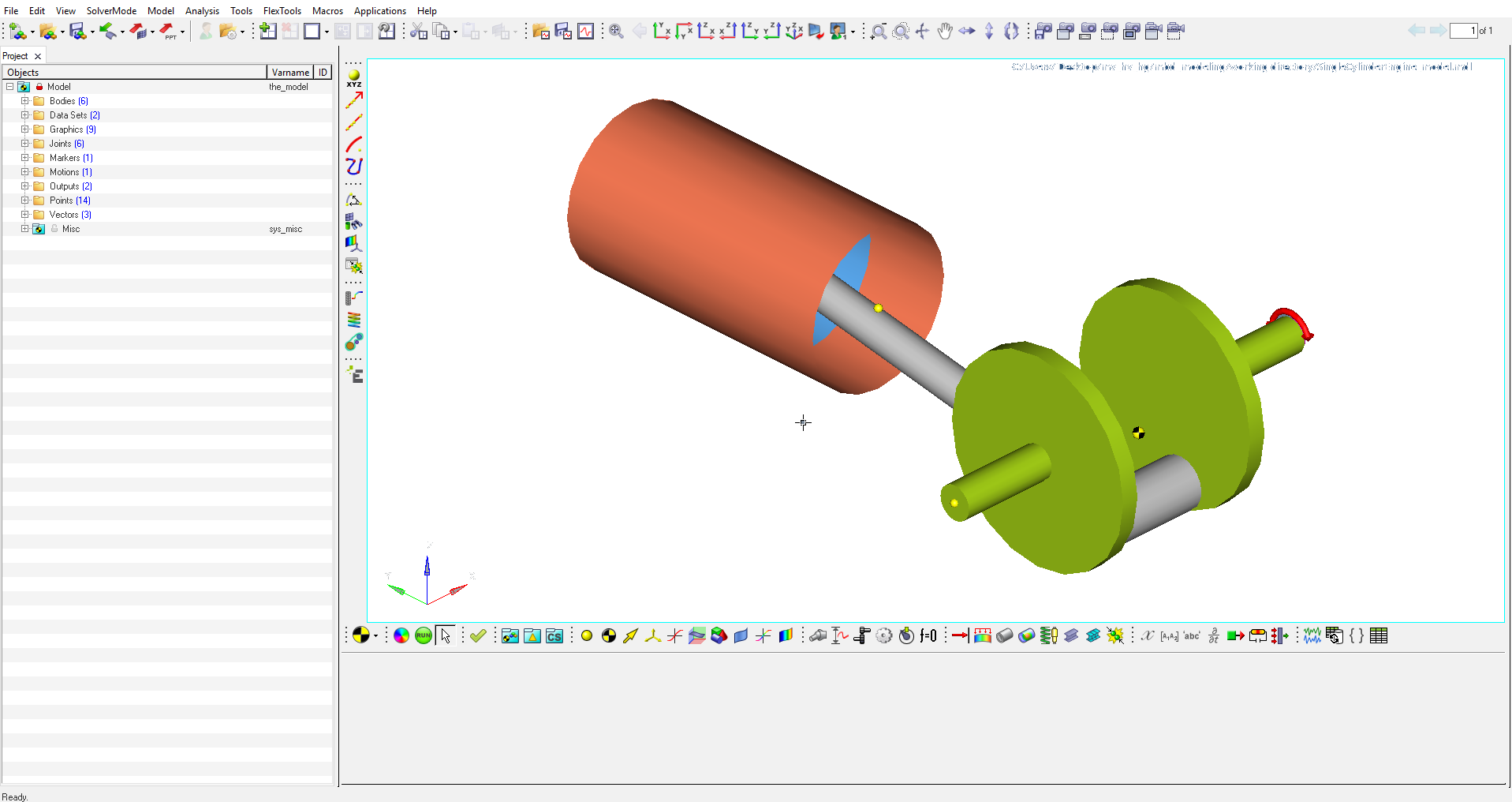

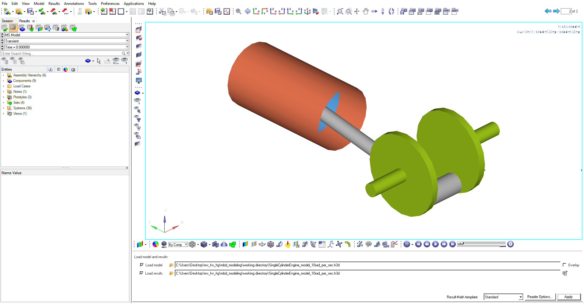

Figure 1.The image below shows the HWD graphical user interface with MotionView activated as the client:

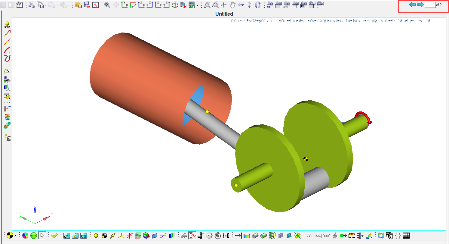

Note: To navigate through different pages of a session, use the Previous Page or Next Page buttons (located at the upper right corner of the window, below the menu bar area and above the graphics area). See the Page Display and Navigation Area topic for additional information.

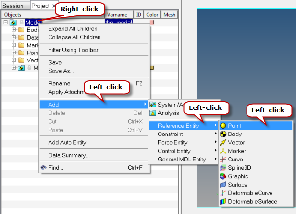

Figure 6.A right click on an object brings up a context menu with options that are relevant to the selected object.
For example, a right click on a Point entity brings up a context menu that provides options to either: Deactivate, Rename, Add, Delete, or Cut the point entity along with options to filter entities.
Figure 7.Similarly, a right mouse click on the Model (the topmost folder in the browser hierarchy) displays up a context menu with options useful in model building.
Figure 8.

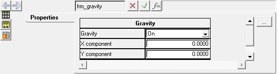

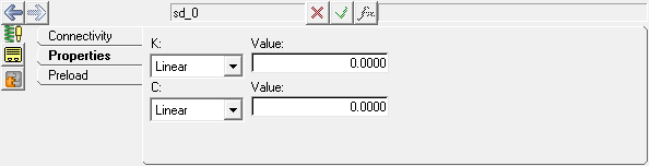

Figure 9. - Properties tab
- Allows you to set the stiffness and damping properties of a
spring.

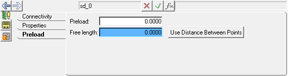

Figure 10. - Connectivity tab
- Allows you to set a 'preload' on a spring by specifying a
force value or spring free length.
Figure 11.

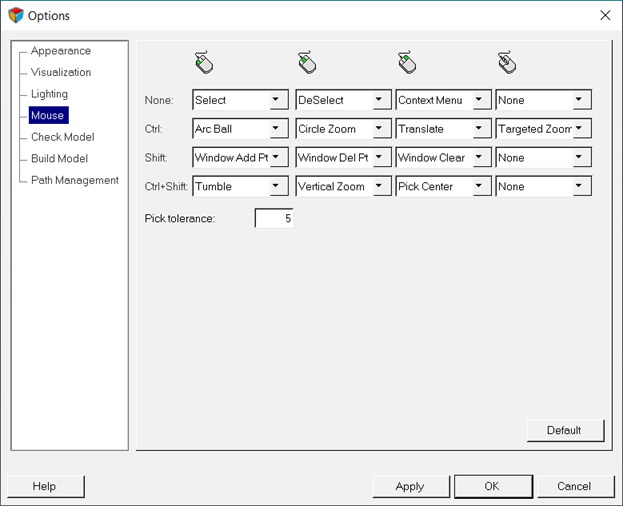

- Graphics Window
- Graphics window is the model visualization area where you can
interactively work on the model. The following table illustrates the various mouse clicks available for model visualization:
Operation Action Left click on an entity like a Point, Graphic, etc. (while the Entity Selector and an entity icon is depressed in the toolbar). Selection (the selected entity is highlighted by a white boarder around it). Hold the left mouse button and move over the model (while the Entity Selector and an entity icon is depressed in the toolbar). Displays the entity name on the mouse tooltip and selects the entity upon releasing mouse button. Right-click on a model entity. Displays a context menu with various options: Select, Cut, and Delete against each entity name. Ctrl + Left mouse button Rotates the model (observe the mouse tooltip). Ctrl + Left click Picks the center of rotation. Ctrl + Right mouse button Translates/Pans the model. Ctrl + Middle mouse button Selects the window to fit. Ctrl + Middle click Fits the model to the window. The controls for the mouse can be found under :
Figure 12.You can customize the mouse controls using this dialog.Note: The items under the Main Menu, Browser, and Client specific toolbars differ from client to client.

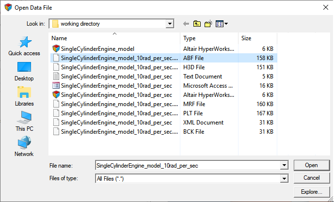

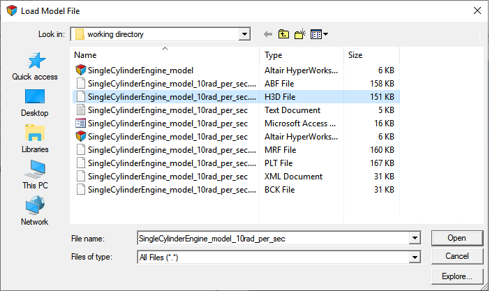

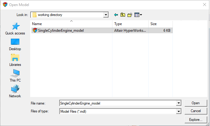

Open a MotionView Model File
In this step, you will learn how to open a MotionView Model file.

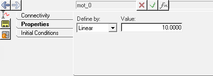

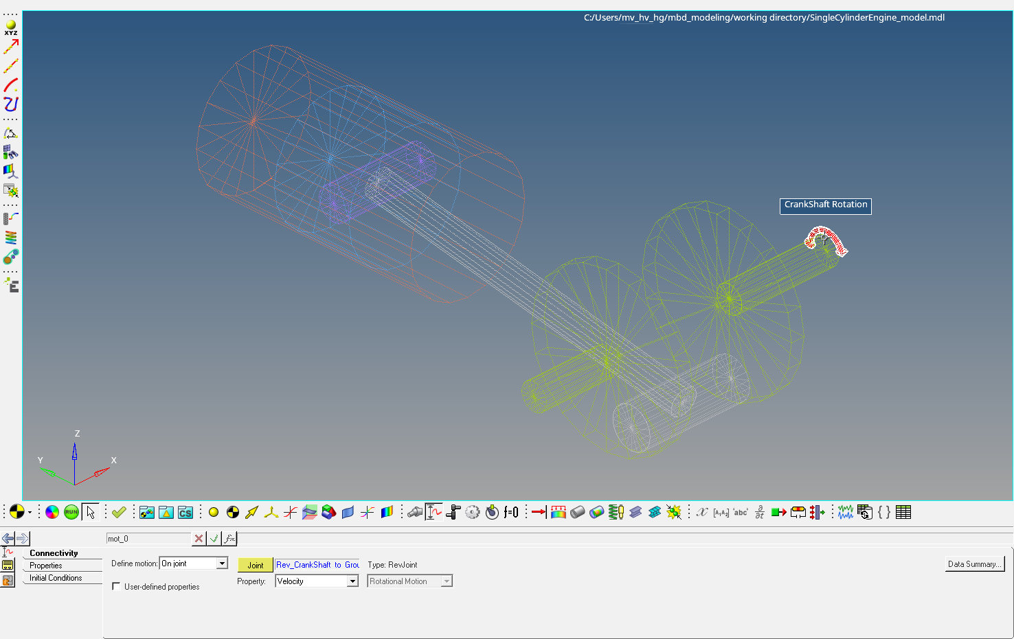

Select and Modify a Motion
In this step you will modify the crank shaft rotational velocity to 10rad/sec.

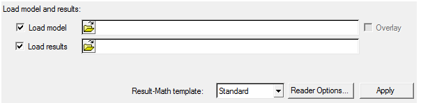

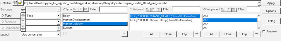

Add Pages to a Session

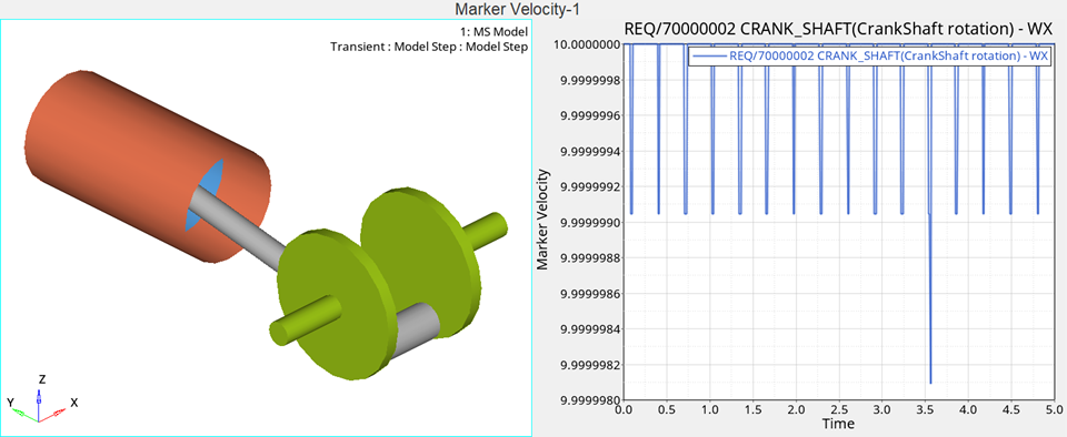

In this step you will learn how to add a page, change to different HyperWorks Desktop clients, change the page layout, and navigate between pages. You will also load the result files to view the animation and the plot.

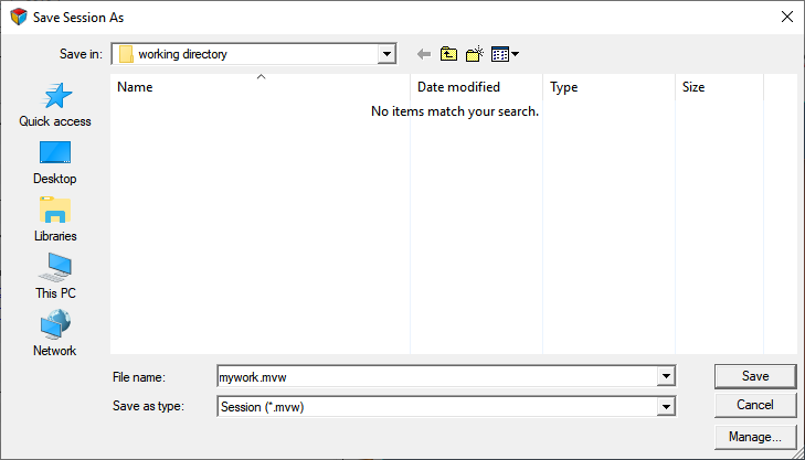

Save a Session File
In this step you will learn how to save your work as a session file.

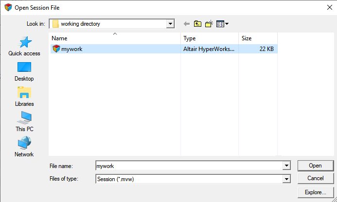

Open a Session File
In this step, you will learn how to open a session file in MotionSolve.
