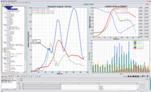

Visualize Results - Animation and Request Plots
- Easily grasp the physical phenomena.
- Quickly detect errors.
- Create compelling presentations.
These images illustrate HyperWorks' powerful tools for visualizing the results of multibody simulations in the form of 2D and 3D plots and animations.

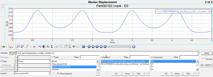

Plots
Plots are essential for obtaining detailed information regarding system behavior as well as for subsequent engineering calculations, such as filtering.
- Altair Binary Format (ABF): This binary file is optimized for fast plotting of very large data sets. This is the recommended format for plotting.
- Multibody Results File (MRF): The primary purpose of this binary file is to provide part displacement data to the post-processor module that creates the H3D file used for animation. The H3D file format is discussed later in this document. The MRF file can also be used to create plots. However, the performance may be slower than the ABF file.
- Plot File (PLT): This is an ASCII file that can be plotted using HyperGraph. The primary purpose of this file is to facilitate load transfers from MotionSolve to FEA software, such as Nastran and OptiStruct, for durability simulation, using the Load Summary utility available in MotionView.
The MRF and ABF files contain, by default, the displacement time histories of all parts and certain other information as shown in the table below:

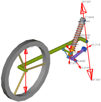

Forces and Moments
Figure 2. Animating Force Vectors

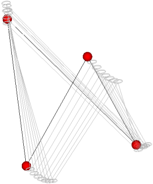

Outline
Figure 3. Outline Graphic Connecting Four Spherical Bodies

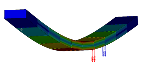

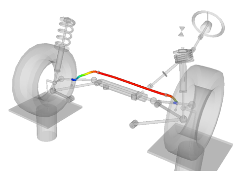

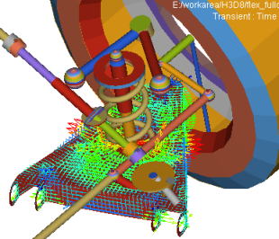

Flexible Bodies
- Contour plots
Figure 4. Result Contours for CMS Flexible Control Arms for a SLA Suspension Model
Figure 5. Result Contours for an NLFE Stabilizer Bar in a Front Suspension ModelYou may contour results of various types including displacements, rotation (CMS only), velocity (CMS only), acceleration (CMS only), strain, and stress. For strain and stress, you must request the corresponding modes to be computed during the component mode synthesis solution for a CMS flexible component; for an NLFE body, these are written to the H3D by default.
Note: The NLFE element results are always written in NODAL format whereas the CMS flexible results can be written in NODAL or MODAL format (this is controlled by the FORMAT_OPTION) attribute in the H3DOutput command statement. - Vector plots
Figure 6. Displacement Vectors for an NLFE Beam Superimposed on the Stress Contour PlotYou may create vector plots of the following data types: displacement, velocity (CMS only), acceleration (CMS only), force (CMS only), and moment (torque, CMS only). The vectors may be resolved in a variety of coordinate systems. Scaling and querying are also supported. The vector plots can also be overlaid over the stress contour plots.

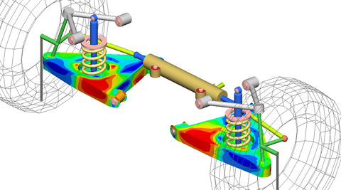

- Tensor plots
Figure 7. Stress Tensors for a Control Arm in an SLA SuspensionYou may create tensor plots to visualize tensor quantities such as stress and strain. Two formats are available - Principal or Component. The tensors may be resolved in a variety of coordinates systems. Nodal averaging is also supported.
For all these visualization approaches, displacements and deformations are available by default, while stresses and strains must be requested during the component mode synthesis (CMS) solution.

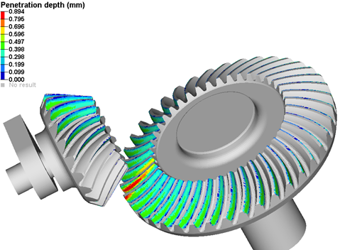

3D Rigid Body Contact
During a simulation that contains rigid body contact elements, MotionSolve computes a number of contact related quantities like normal force, friction force, slip velocities etc. These are written to the H3D after the simulation so that they can be visualized in HyperView.
- Contact summary frame:The contact summary frame is a single frame in HyperView which allows you to visualize the maximum penetrations that occurred in your 3D geometries over the length of the entire simulation. A sample contact summary frame is shown below (in exploded view).
Figure 8. Contact Summary Frame for Bevel Gears in ContactMotionSolve writes an additional load case, called “Contact Overview” to the animation H3D file when the model contains active 3D rigid body contact(s). Within this load case, you can create a contour plot defined by maximum penetration depth.
The summary frame allows you to quickly check for excessive penetrations in your simulation before animating it. It can also be used to assess whether the areas where contact occurred are as expected. For more information on the contact summary frame, please see the Post-processing section in MV-1010: 3D Mesh-to-Mesh Contact Simulation.

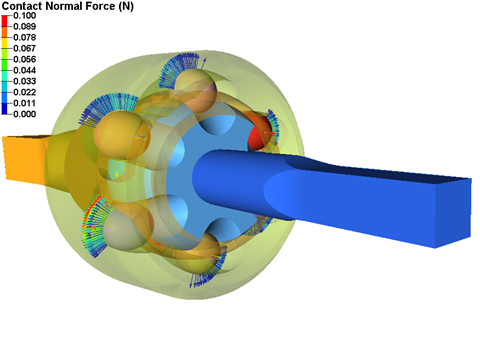

- Vector plots:You may also use vector plots to display contact forces and velocities. In addition to the total contact force, you can visualize several other results including contact friction force:
Figure 9. Contact Related Vector Plot Results
Figure 10. Normal Contact Force for a Constant Velocity Joint GeometryYou can plot these vectors for each triangular element on the rigid body or for a contact region.

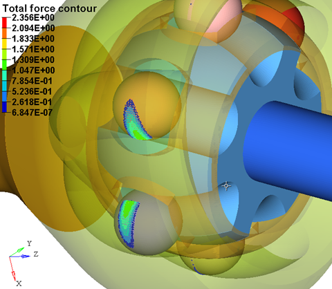

- Contour plots:You may also use vector plots to display contact forces and velocities. In addition to the total contact force, you can visualize several other results including contact friction force:
- Contact force (including normal and friction force)
- Contact velocity (including normal and tangential velocities)
- Contact penetration depth
Figure 11. Total Contact Force Contour for a Constant Velocity Joint Geometry
