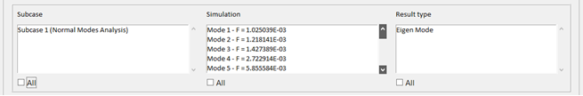

The results available (subcase, simulation, and result type) in the current result file are loaded in the three windows.
Figure 1. -
Select All under each of the windows and click the
second Apply button.
Any combination of Subcase, Simulation, and Datatype can be selected for comparison. Comparisons of the current and reference results are generated.

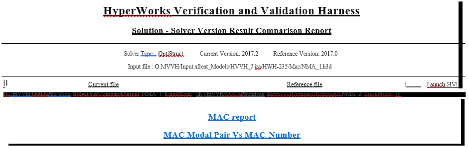

If the difference is greater than the tolerance, it is indicated with the label Fail; otherwise they are labeled Pass.
Click HTML Report to view the HTML report.
Comparisons between different data types are available.

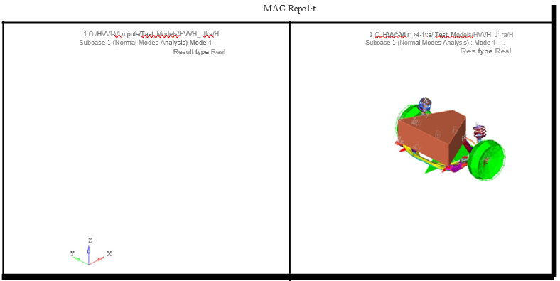

From the HTML report, click MAC report to open the
correlation plot and mode pair bar plot.

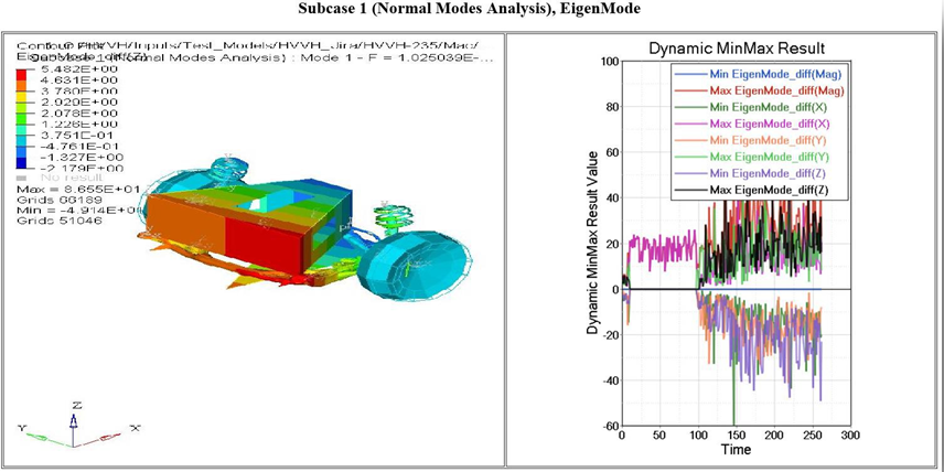

Click the first column of the table to open a new modeling window.
Figure 7.In the image above, the left window shows a diff contour (Current-Reference) and the right window shows a diff plot in HyperGraph.
Click the left window to open the diff-values in H3D in HyperView Player.
You can view the difference in the contour and view the area where there is a difference in case of a failure.
Click the right window to maximize/minimize the plot.
The difference values for each step are calculated and the min and max values of the difference are plotted. If all the values match and no difference is seen, the curve is a flat line and the diff contours have values less than the tolerance.

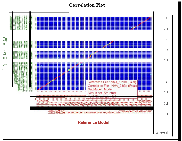

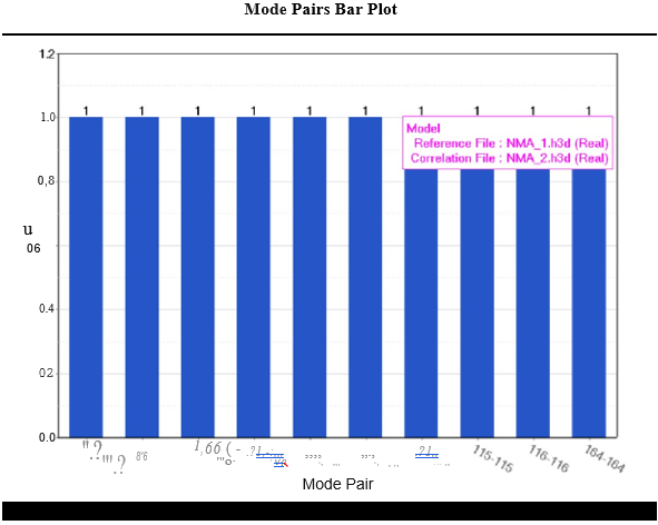

From the HTML report, click the link to the MAC report to open the correlation
plot and the mode pair bar plot.

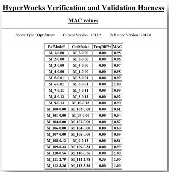

This gives information on the model correlation across two results and the modal pairs with different MAC numbers.
Mode number, frequency, percent frequency difference, and MAC values are listed in the MAC table.
