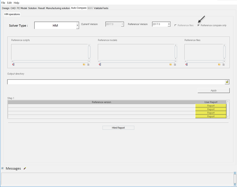

- Use case 1
- Compare any HyperMesh version output and
reference files compared with output and reference files.

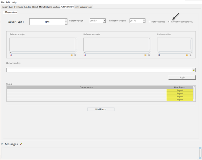

Figure 1. - Use case 2
- Current and reference HyperMesh versions -
no reference file required.
- Current version and reference version output and reference files are compared.

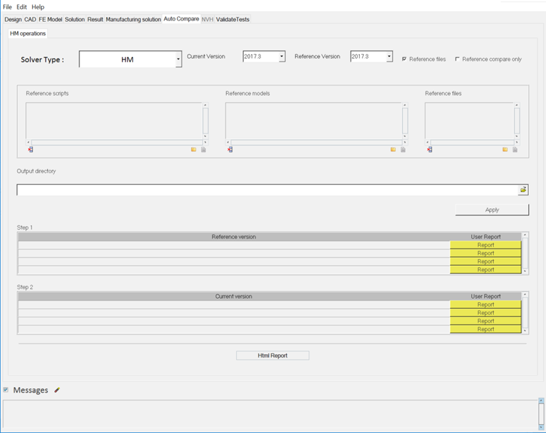

Figure 2. - Use case 3
- Current and reference HyperMesh versions.
- Step1 - Reference version output and reference files compared with output and reference files.
- Step2 - Current version and reference version output and reference files are compared.
