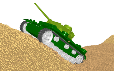

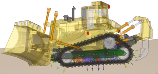

- Track Model
- Altair’s multibody dynamic products (MotionView and MotionSolve) include a continuous track plug-in for tracked vehicles, such as bulldozers, excavators, robots, snowmobiles, and military vehicles. The track plug-in automatically assembles a continuous band of treads or track plates driven and suspended by two or more wheels, which can interact with a soft-soil surface. The user interface of the track plug-in is implemented in MotionView. MotionSolve includes all necessary elements, such as the soft-soil model and the interaction with the track links, to simulate a tracked vehicle. The track plug-in is meant to be run through MotionView only and, hence, a solver-only version is not documented.

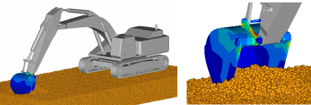

- MotionSolve and EDEM cosimulation - Flex Body Contact
- MotionSolve can interface with Altair EDEM, a state-of-the-art bulk material simulation tool. EDEM is based on the Discrete Element Method (DEM) that simulates and analyzes the behavior of bulk materials, such as sand, granules, capsules, grass, rock masses, and so on. New to this cosimulation is the capability for component model synthesis (CMS)-based flexible bodies to interact with DEM particles. CMS flexible bodies can represent body deformation in the linear range. Reaction forces due to contact between DEM particles and the flexible body are simulated, which lead to strain and stresses within the flexible body. Absolute nodal coordinate formulation (ANCF)-based non-linear finite elements (NLFEs) are not supported to interact with DEM particles at this point. This feature will be part of a future release.
