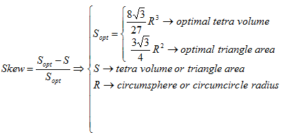

- Skewness: Equiarea or equivolume skewness is a non-dimensional parameter
with range 0 (equilateral triangle or tetrahedron) - 1(degenerate element)
defined as
Quality meshes of complex models typically have tetrahedra with equivolume skew < 0.9 and surface triangles with skew < 0.8. Default values are 0.85 (tetras) and 0.7 (triangles).
