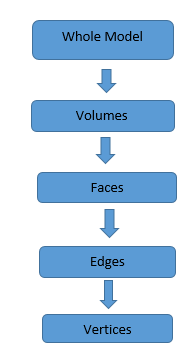

Figure 10. Hierarchy of CAD Model Entities for Meshing Parameters
Mesh attributes can be set on a global (whole model) and/or local (model entity) basis. An attribute specification applies to the closure of an entity, so if a size is specified on a model face the model edges and model vertices on the boundary of the face will inherit the same size specification. However, a separate size specification may be given for the edges and vertices in each case. If conflicting mesh sizes are specified, regardless of whether they are from the same type of mesh attributes or not, AcuMeshSim will pick the smaller of the resulting sizes.
